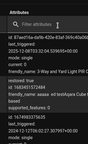

Look here to see what attributes are available.
Open your Home Assistant instance and show your state developer tools.
Thanks for that.
I had looked there before, but was confused by the ‘signal’ part of the Wiser parameter name. I’ve now looked at the Sonoff version and the pennies dropped. :slight_smile: So I understand a little more and I’ve managed to access the temperature value.
