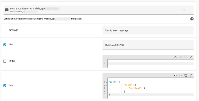

Taking a quick look at the companion app docs, it shows the value for critical as 1. Aside from that can you go to devtools → actions, try to send a text from there with the critical key and see if it works there.
I do successfully get critical notifications on this device… but only with a Node Red subflow (code below).
I did review the critical page in the Companion App docs, and not being able to get that to work led me here.

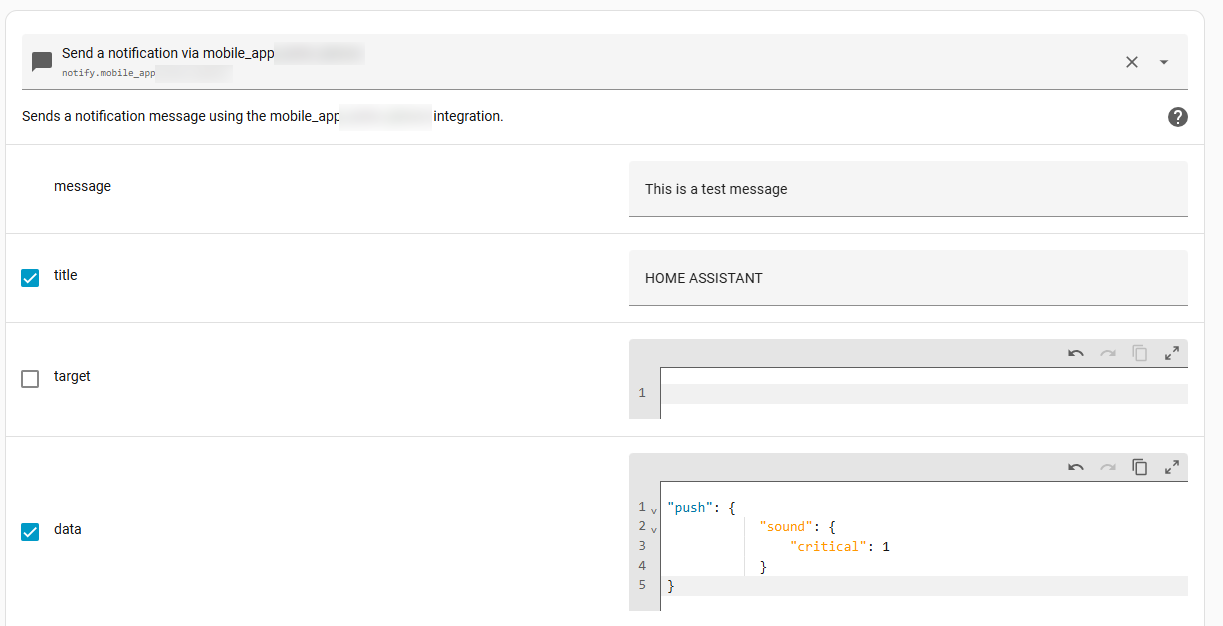

Here’s what I tried in the Dev Tools page:
BUT… that did not work either. With the Data field cleared out, it works fine.
