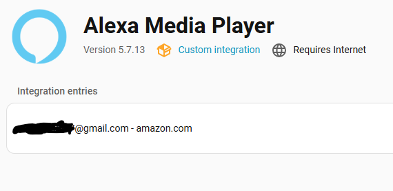

I believe I did what you suggested; however, I have Alexia Media Integration listed under Integrations, but no devices are listed.
  1. deleted Alexia integration
  2. removed HACS Alexa
  3. restarted HA
  4. searched HACS for Alexa and downloaded
  5. HACS Alexa download required a restart
  6. added Alexa integration
  7. required 2 step auth. which completed successfully
I have just the Integration line and no devices underneath it
Tried integration reload and a HA reboot, no help.
Suggestions?
Screen Capture of Integrations
Sorry, failed to note I am using the Nabu Casa method of authentication for Alexa. I receive a code to my mobile and I input on the screen under my login for already existing account.
Screen shows connection and completion with Alexia.
Then I get the one line for Integration but no devices and still no notify.alexia_media in actions.
