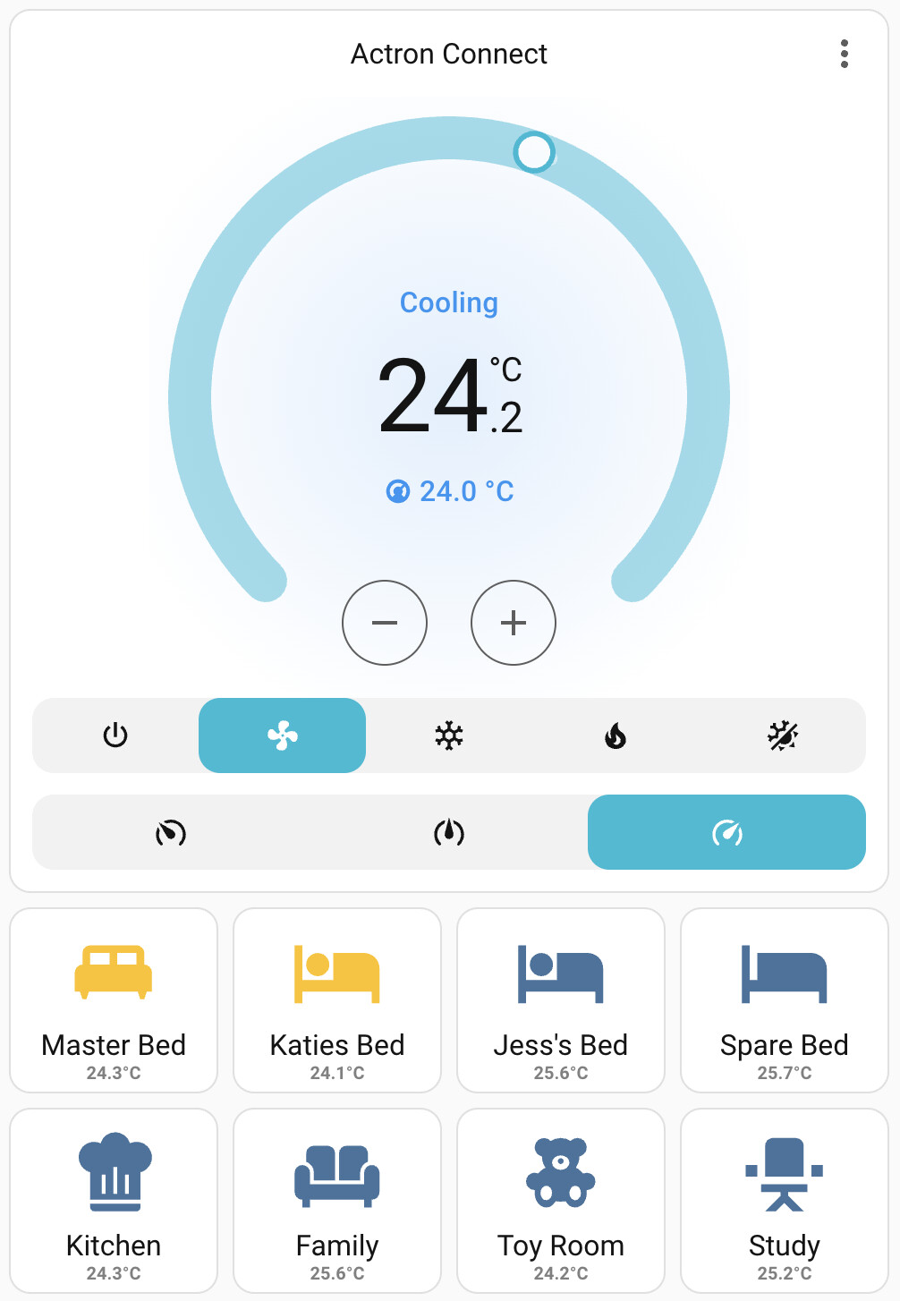

The integration uses the standard climate entity type, which is compatible with the built-in Thermostat dashboard card. Zone information is not available on the Thermostat card, but can be accessed and controlled via the standard Switch entities that the integration exposes.

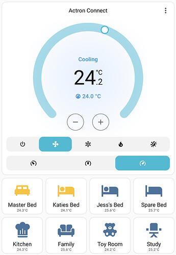

Once set up, this is what it looks like:

@fruffin Great work getting this Integration working. I’ve installed it and have got it running with my Actron ESP Ultima with 8 zones and all seems to be working well.
I am migrating slowly to Home Assistant from Hubitat where I wrote my own Actron Connect integration so your work has saved me trying to write the integration myself. One feature I am missing from your integration is the ability to see the temperature in all the individual zones, as its handy to be able to quickly glance at all the temperatures for all zones.
Is this something that your looking to add in the future?

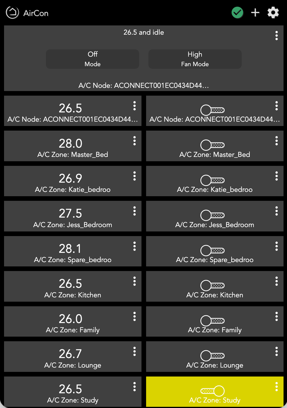

@dcoghlan I didn’t know that was a thing :slight_smile: Mine doesn’t support that. I only get the on/off status for each zone…
If you could send me an example payload from your unit, I can try to work that in.
You probably know this already if you have already built an integration for Hubitat, but if you browse to the IP address of your unit, you should be presented with sample JSON payloads for each of the API’s endpoint.

No worries @fruffin here is the output from 6.json which is where the individual zone temperatures are reported.
    "isOn": false,
    "mode": 2,
    "fanSpeed": 2,
    "setPoint": 22.5,
    "roomTemp_oC": 26.5,
    "isInESP_Mode": true,
    "fanIsCont": 0,
    "compressorActivity": 2,
    "errorCode": "",
    "individualZoneTemperatures_oC": [
        27.1,
        26.4,
        26.8,
        27.3,
        25.6,
        27.3,
        25.9,
        27.0
    "enabledZones": [
        1,
        1,
        1,
        0,
        0,
        0,
        0,
        0
    "liveTimer": null

@dcoghlan I’ve had a bit of time this afternoon to implement this. If you update the integration to the latest version on GitHub and restart HA, it “should” now expose the sensors you wanted. I say “should” because I was only able to test with mock data.
Let me know how it goes.
Awesome, thanks @fruffin
Just spent a bit of time installing it and setting up my dashboard using custom:button-card and am very happy with it now.

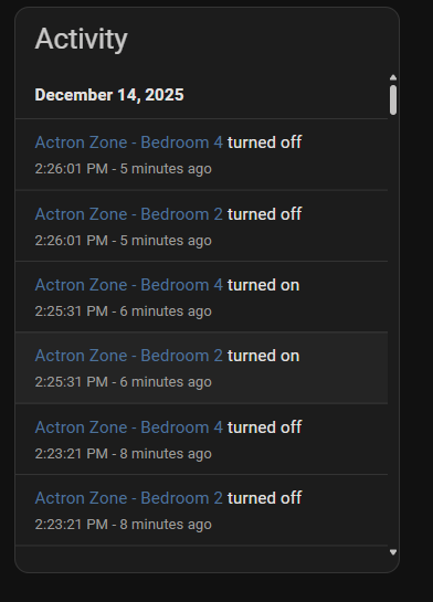

Hello all, this a fantastic thread and thank you for Actron development.
I was further behind because I had lost the ability to connect to my unit so I had to get the app working.
I found that if you use a Premium version of AppCloner it will offer to update the SDK in the background, doing that I got the App to open on my pixel fold, it was a little buggy but it worked. I might be able to share a copy of the cloned APK if anyone needed it.

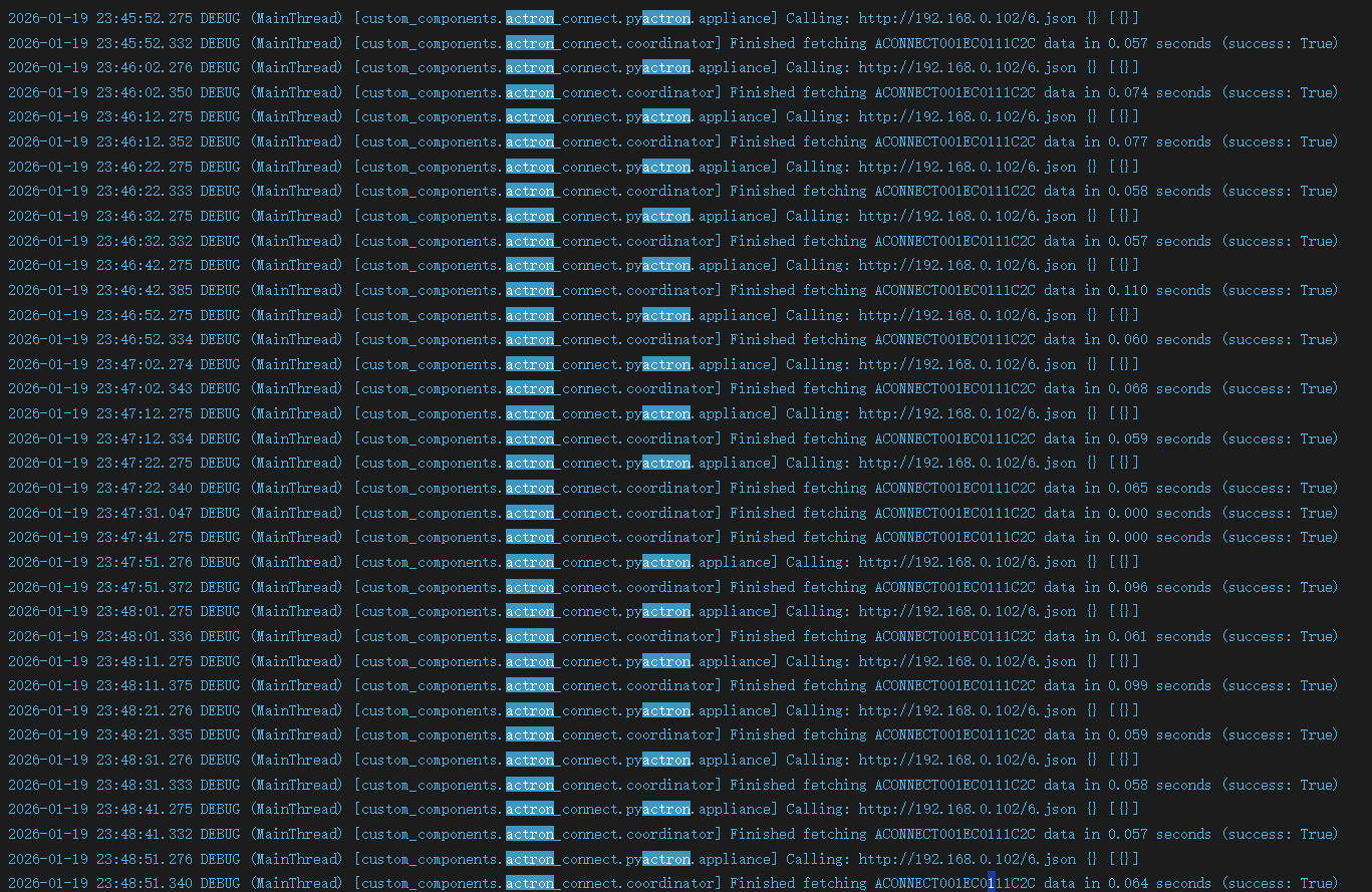

I was able to install your integration and I have the unit showing up and I can see the on/off and the main temperature, but it didn’t detect the zones despite them showing up in the Actron app when I log in.
Temperature and fan speed changes still revert to the previous state within 30-40 seconds.
I use the same login credentials for the web portal and the HA integration.
Here are the logs from debug mode:
Thanks for your help.
