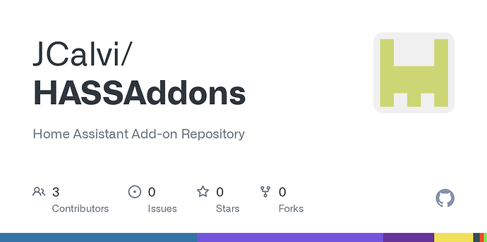

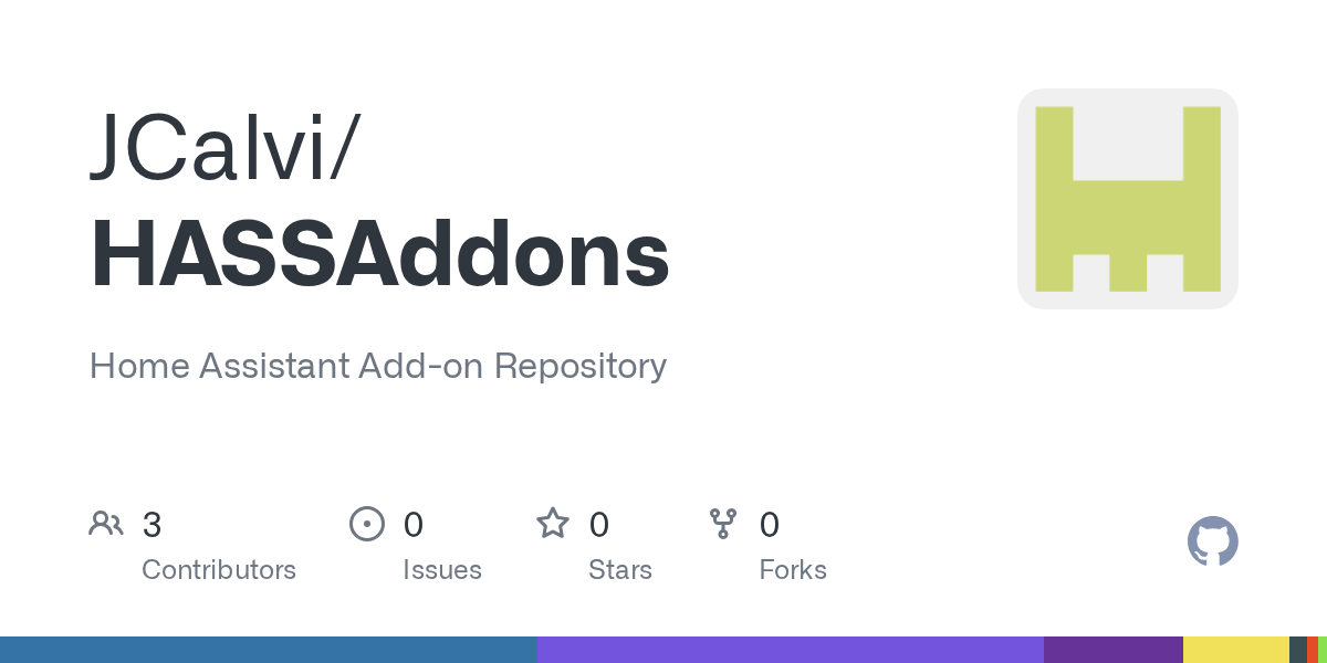

Installation / GitHub
The add-on is available in my Home Assistant add-on repository:
Direct link to Actron QUE Local:
Add the repository to the Home Assistant App Store, then install Actron QUE Local.
MQTT is required, and the Home Assistant host needs network access to the QUE master controller. I recommend giving the QUE master a DHCP reservation so its IP address remains stable.

For future reference, the term HASS means Hate in German and because of that was dropped 4 or 5 years ago from customer side usage in favor of HAOS or just HA. A little still remains but it is pretty well gone. The term Add-ons was dropped over a year ago in favor of Apps.
People might look at your stuff and have no point of reference what any of it means. Using the term add-ons in new software or in installation docs can be very confusing to people who have never seen an add-on, only apps.
Just something to consider in the future.
If you are looking for an ez-button to help with installation instructions, look here: My Link / EZ-Button to help users install your App
