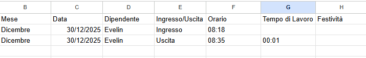

Actual duration input_text to send to Google Sheet using the right template
I created a blueprint using an input_text. If it finds “Exit,” it sends the time spent in “Entrance” to a Google Sheet file. It seemed to work, but I noticed that after selecting “Entrance” and restarting HA, the elapsed time was erased, starting from 0, and when I selected “Exit,” the elapsed time written to Google Sheet was lower than the actual value.
So I created the following sensor that tracks the time spent in entrance during the day. I should insert this sensor into my blueprint to write the correct value to Google Sheet, but I’d like something simpler to avoid creating the sensors in HA.
So, how could I write the correct formula to get the correct value for the sum of the time spent in “Entrance” when HA is restarted?
I’ll provide you with the code from my blueprint.
Thank you.

I tried to enter your code, but it doesn’t work. I’m probably entering it incorrectly.
I wrote it this way, it returns the value but the automation gives me an error
    '{{ name_column_6 }}': >-
      {% set x =
      as_timestamp(states[trigger_state_entity].last_changed)|default(0,1) %} {{
      (now().timestamp() - x)|timestamp_custom("%H:%M", false) }}
You can’t template YAML structure.
You’ll have to excuse me, but I’m not an expert, I don’t understand your answer. Are you telling me it’s not possible? Even if I can see the value but it doesn’t write it to Google Sheets?
I’m telling you that…
      {% set x =
will not produce valid YAML. You need to template the entire value for data so that it returns a dictionary:

Are you telling me I have to write it this way? I tried it but it doesn’t work.

Now I understand the concept, entering your function code correctly.
However, when I do some tests, when HA restarts, the time elapsed between “Entry” and “Exit” resets.
That is unavoidable, because you are using last_changed which will reset on restart.
There are a couple ways to accomplish what you are trying to do… but if you want it to all happen in the blueprint-generated automation, your only real option is to enable add_created_columnin your google_sheets.append_sheet actions and use the google_sheets.get_sheet action to query the sheet and search for the previous event for the current person, then calculate the difference.
Other things to consider:
There is a missing condition to link the trigger_name variable from the input to the name value coming from the actual trigger variable object. As currently configured, if someone creates multiple version of the automation for different employee-based sheets, the data in the sheets won’t be employee-specific. All sheets will be populated with all tag scan events.
Even if you add the query, the automation relies on the Input Text as the source of truth for what is an “entering” event and what is an “exiting” event. What happens if it gets out of sync with reality?
I understand, I’ll try to give it a try. I wanted to create a blueprint that was accessible even to less experienced users (like me), to avoid creating sensors and lines of code to make the blueprint work.

I’m trying to figure out how to retrieve the value from the Google Sheet cell, the only thing I can retrieve is the entire row, by doing this…
action: google_sheets.get_sheet
  config_entry: 01KCDZG10HEQF415
  worksheet: Presenze Evelin
  rows: 1
range:
  - - "2025-12-30 09:00:33.709347"
    - Dicembre
    - 30/12/2025
    - Evelin
    - Uscita
    - "09:00"
How could I retrieve only the value of the cell that shows the time?
I followed your detailed guide and wrote the following code… but it returns an error. I wrote time_in without the {{}} and without the "" but I still get an error.
For now, the way it’s written is just a test. I wanted to display the input date value in column 7 to see if it was written correctly, but it isn’t.
