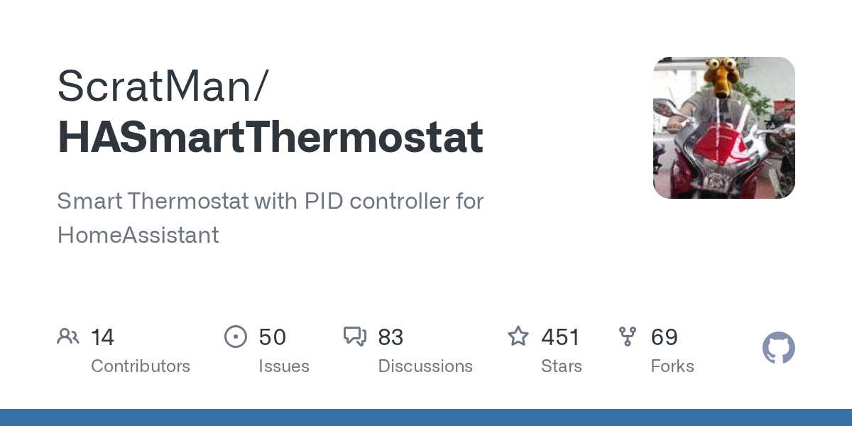

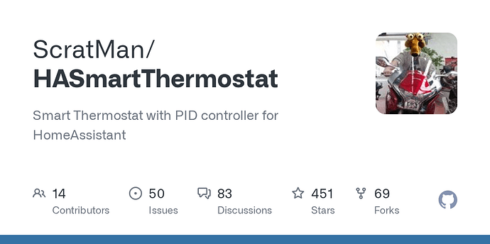

I haven’t used it, but there is a custom component available in HACS:
I don’t believe the Sonoff TRVs (or indeed most domestic smart TRVs) support PID.
