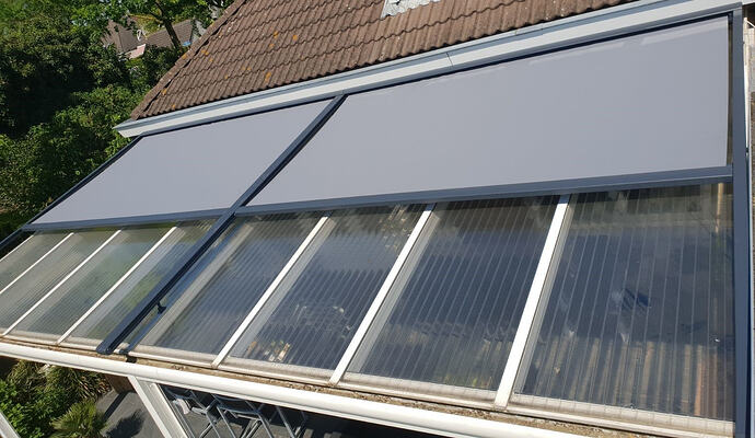

What are the best settings for screens covering a tilted window? Like this.
