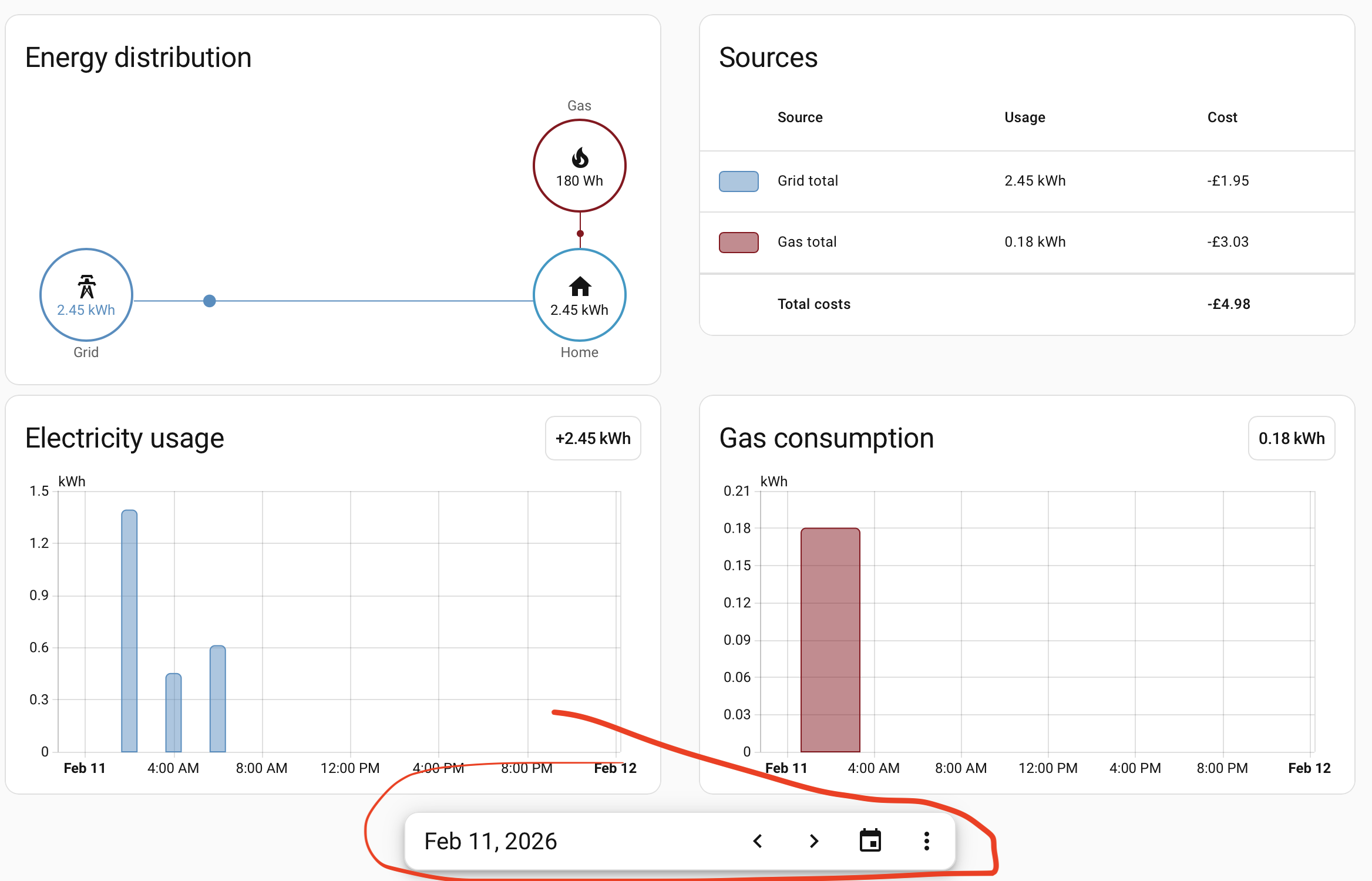

There’s a nice date picker in the built-in energy dash, which does exactly what I want:

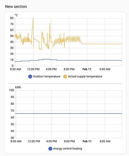

The default graphs in my WIP custom dash are OK, but I’d like to add this date picker, and also to have the graph display the whole day instead of the last several hours:

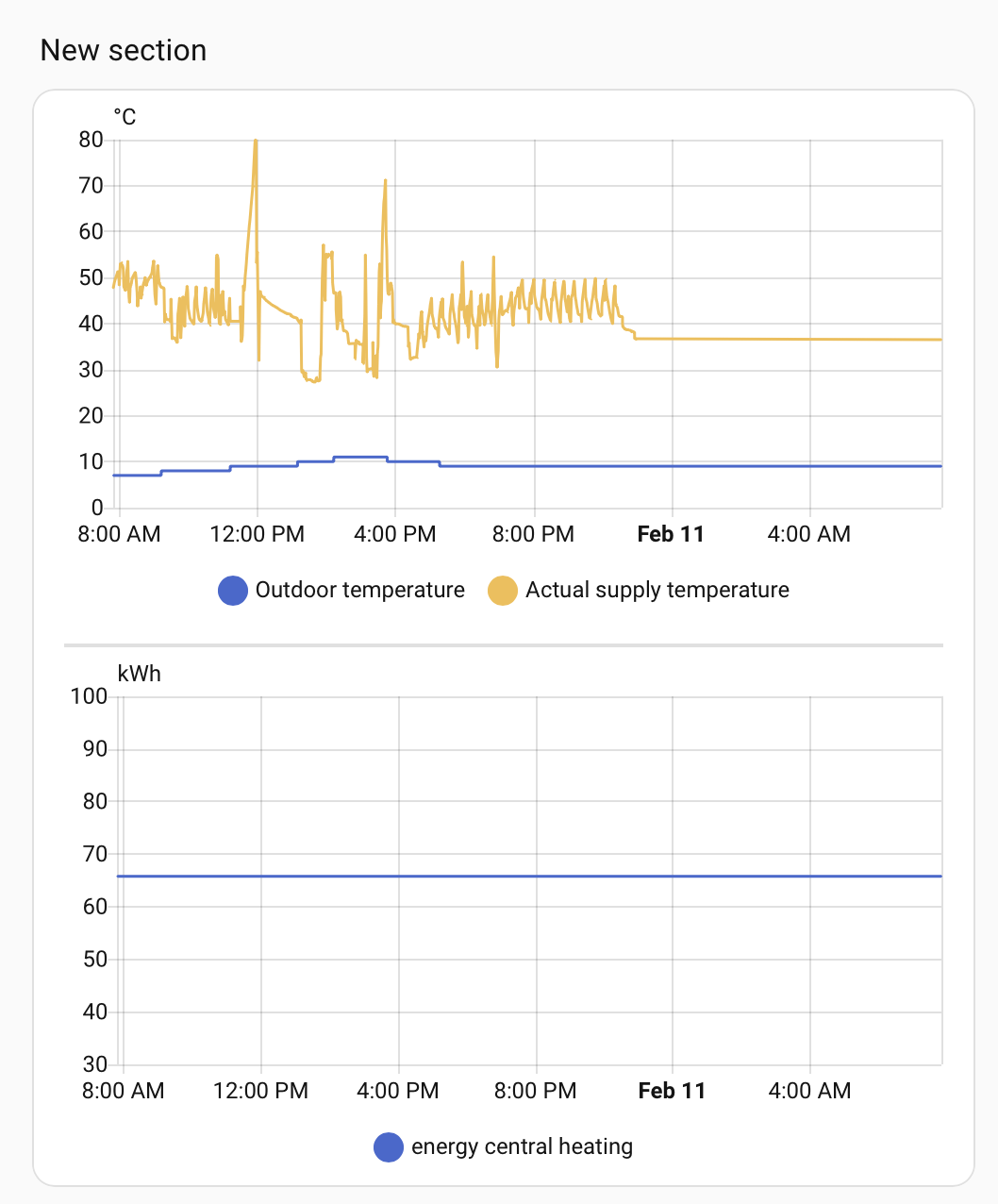

This is relatively simple with a custom button card. Furthermore, replacing “energy-date-selection” with a date helper makes this solution alot simpler, so I did that. My test helper entity ID is input_datetime.energy and is set as variables.helperId.
Example with 2 history graphs
