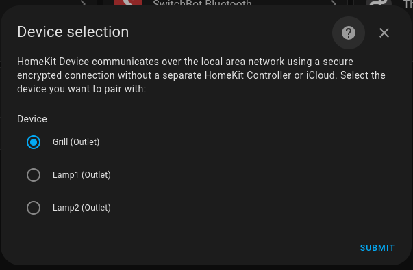

Thanks. When I attempt to add the HomeKit Device integration, I am given a choice of devices, none of which is my Aqara FP2 though (see screenshot below)! What am I doing wrong?
You have to get the FP2 into pairing mode. If I remember correctly, you have to hold down the button for like 10 seconds, at which point the FP2 LED will start blinking. Then start the HomeKit integration on Home Assistant.
I did put the FP2 into pairing mode, but I still can’t see it in the “Device selection” box.
Any other opinions?
