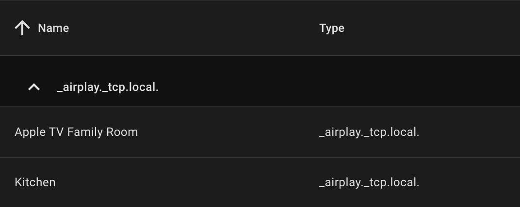

Are mDNS advertisements different than other Zeroconf? I just started up a HA container in host mode and it’s seeing my network.
And inside the container I can resolve .local addresses:
