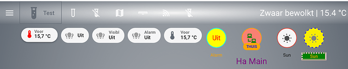

Old style badges really are a state-badge-element like used in the picture-element cards.
We can use these adding the following ‘trick’, namely pretending they are custom, by prepending with custom:hui-:, making that into:
type: custom:hui-state-badge-element
(having a bit of styling fun with them is also possible using the new card_mod 4.0.0, but, as this post is not to focus on the card_mod options in particular, please go to that link if you want more on that )
As stated above, this post is to showcase, as sought by many:
How to use badges elsewhere in the views, outside of that badges section.
Turns out it uses the same ‘trick’ as above: prepend with custom:hui- to get things done.

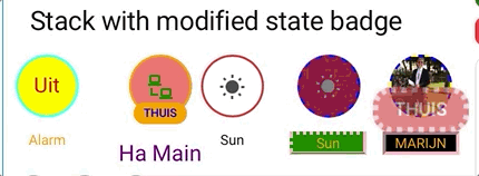

We can use the exact same old_style badges like that:
    - type: horizontal-stack
      title: Stack with modified state badge
      cards:
        - type: custom:hui-state-badge-element
          card_mod:
            style: |
              :host {
                color: orange;
                --label-badge-text-color: red;
                --label-badge-red: cyan;
                --label-badge-background-color: yellow;
                --ha-label-badge-label-color: blue;
          entity: light.alarm
          tap_action:
            action: toggle
          hold_action:
            action: more-info
          entity: device_tracker.ha_main
        - etc
Oct-14-2025 14-20-09

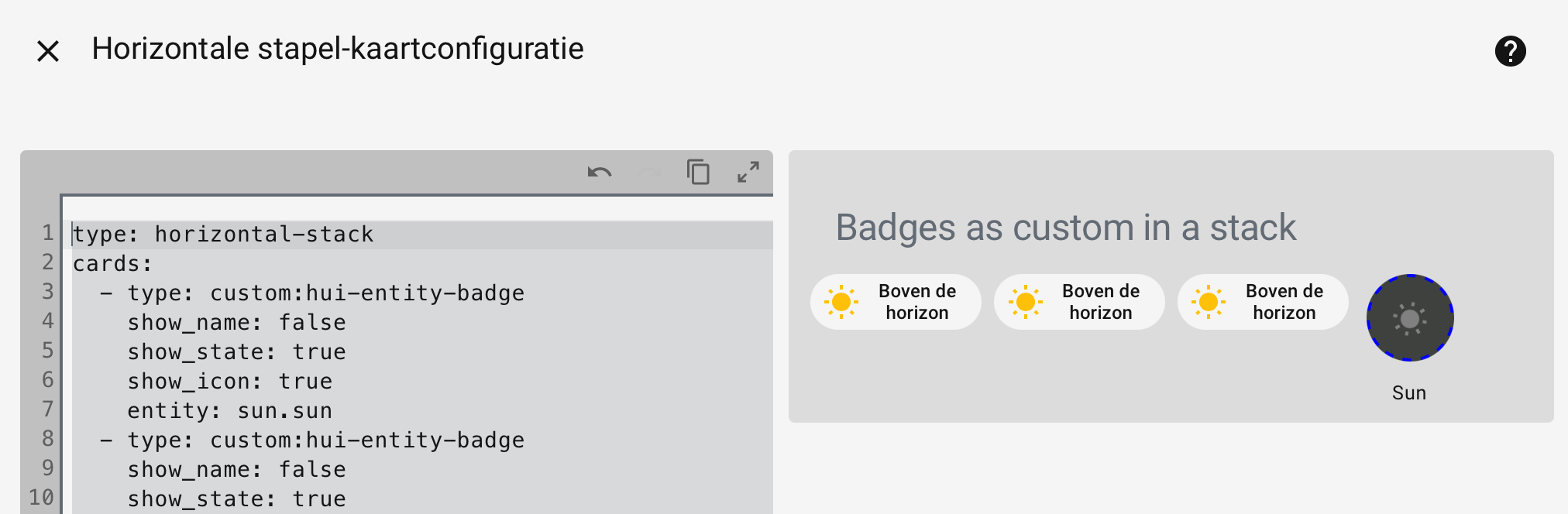

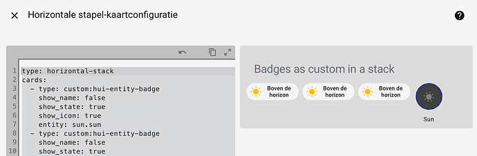

and also the modern badges, (see this for some styling examples) and even combine them with eg an old style badge
cards:
  - type: custom:hui-entity-badge
    show_name: false
    show_state: true
    show_icon: true
    entity: sun.sun
    show_name: false
    show_state: true
    show_icon: true
    entity: sun.sun
    show_name: false
    show_state: true
    show_icon: true
    entity: sun.sun
    entity: sun.sun
    card_mod:
      style:
        ha-state-label-badge:
         (etcetc see link to card-mod thread)

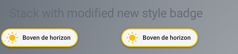

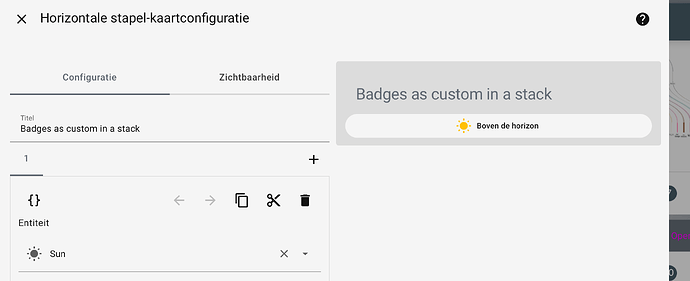

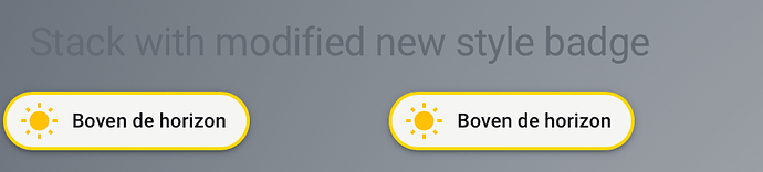

when only using 1 or 2 modern style badges, we need to set the fit to content explicitly, otherwise we get this
which requires 1 single card_mod to make them fit their content, and not use the full stack width:
all we need to do is
title: Stack with modified new style badge
cards:
    show_name: false
    show_state: true
    show_icon: true
    entity: sun.sun
    card_mod:
      style:
        ha-badge:
            .badge {
              width: fit-content !important;
              border: 2px solid gold !important;
              box-shadow: var(--box-shadow-badges) !important;
and make the magic happen

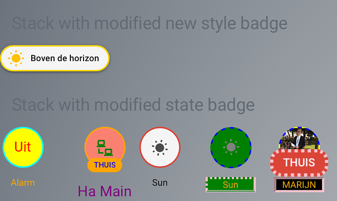

or more:
      cards:
        - entity: sun.sun
          <<: &new_style_badge_in_stack
            show_name: false
            show_state: true
            show_icon: true
            card_mod:
              style:
                ha-badge:
                    .badge {
        - entity: sun.sun
          <<: *new_style_badge_in_stack
