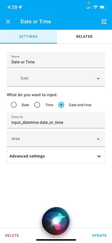

I have created a date or time helper but cannot figure out how to use it in an automation using the Visual Editor.
This is the helper.
How would you add it to an Automation in Visual Editor?

The desire is to have an automation that kicks off on a specific date. I can’t figure out how you enter in the Visual Editor. Is it used as a trigger or condition and how to enter it.
In the trigger section select Time from the pull-down, then click to select the “Value of a date/time helper” option, and fill in your helper’s id/name in the field that appears.
If you are confused about the difference between triggers and conditions in Home Assistant take a look at Understanding Automation Basics
Thanks, reading the basic’s wasn’t really doing it until your advice and a fresh look at it registered that I needed to set the date in the helper section of the overview screen. I understand condition vs trigger it was how to use the helper itself that was eluding me. It has been a long couple of days of getting my Insteon infrastructure running back to and better than it was.
