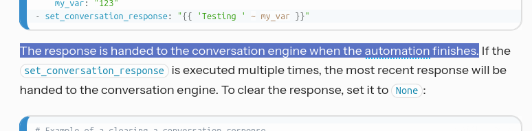

The goal is to have some delay before Assist go to Idle state. If you add just a delay block it would be ignored.
Currently I have:
Responding > Idle
What I want:
Responding + 1 sec delay > Idle

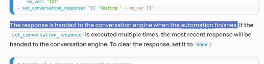

No, set_conversation_response is effectively always run at the end of the automation.
Script Syntax - Respond to a conversation
