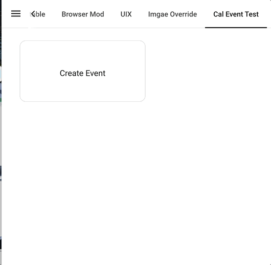

Next: Use as action.
On any Frontend element that accepts an action…
type: button
tap_action:
  action: fire-dom-event
  uix_create_event: true
Note:
  • This leaves a hidden ha-full-calendar in DOM under home-assistant shadowRoot to use again so the code does not have to always reload. Its needs to be under home-assistant so the resulting show-dialog is handled.
  • You could do this with custom:button-card and its javascript action, you would need to do a bit of querySelector chaining to get anchor which is the partial-panel-resolver element that has the info to load the calendar panel and hence ha-full-calendar. UIX Broker makes it easy as the anchor uses express search selector to do this with an easy config.
Sep-26-2026 17-18-40
