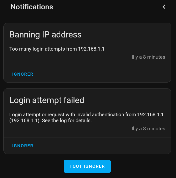

Another month, another IP ban for 192.168.0.1 and another opening of the yaml file then restarting. No idea why there is no whitelist.
Record day for me. 4 blockages today without understanding the cause.
Edit : 5x…
And each time, I have to remove the banned IP and restart HA. But since the Samsung (SmartThings) integration is currently bugging, I have to request a new token at every restart.
Ultimately, I convinced myself that ip_ban_enabled was not properly programmed. So, this should be an issue rather than a PR.
I doubt that, otherwise the issue would be more widespread.
192.168.1.1 is the IP of your router - check if you have any devices on your network with an invalid password. Since you mention the Smartthings integration being buggy, I would start by disabling it for a day or 2 and seeing if the bans stop.
Smarthing has nothing to do with this. I already had this local IP ban issue before having any Samsung devices. The IPs of both smartphones get banned most often when switching between Wi-Fi / 5G / Wi-Fi.
I increased the login_attempts_threshold parameter from 5 to 15 to see if it helps…
In that case, I would suggest to log out from both your smartphones and delete the refresh token from HA (Click your profile icon in the bottom left > Security Tab > Android App 3 dots menu > Delete)
Try logging back in on one phone, once via wifi and once via 5G and check if you get a login warning on your dashboard. Repeat with the other phone if this works.

I tried using a new token, as well as uninstalling and reinstalling the Companion app, but it had absolutely no effect. Switching between 5G and Wi-Fi 5, 15, or 30 times does not systematically trigger the banning of the local network IP. It is a completely random event involving the following factors:
ip_ban_enabled + Companion App + Unknown Event X = Local IP Ban. :rage:
If I’m posting again today, it’s because I got banned from my own network once again, which prevented me from opening my home this afternoon (garage door). Fortunately, I had the foresight to hide a physical key in a Smartlock, as I no longer trust Home Assistant due to its lack of reliability.
I’m not the only one experiencing this issue, and for the past four years, this request has been recurring. But if it is not possible to whitelist an IP, then the bug in the Companion app that causes local network IP bans should be fixed.
After all, fixing the Companion app might be simpler than creating a whitelist when “ip_ban_enabled” is enabled. And disabling “ip_ban_enabled” to avoid local network IP bans would be dangerous.

And clearly companion app has a bug, as I get failed login warning very often, from all the devices that are running the app on android, both internal and external networks.
