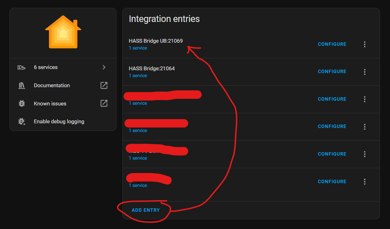

When trying to add a new device through the UI, it seems that HA tries to create another bridge, instead of adding a new device to the existing one.
This is what I do.

It makes sense that the add entry option would do that. For all integrations, it sets up another instance of the integration. Try clicking the configure option on an existing bridge instead. What do you see?

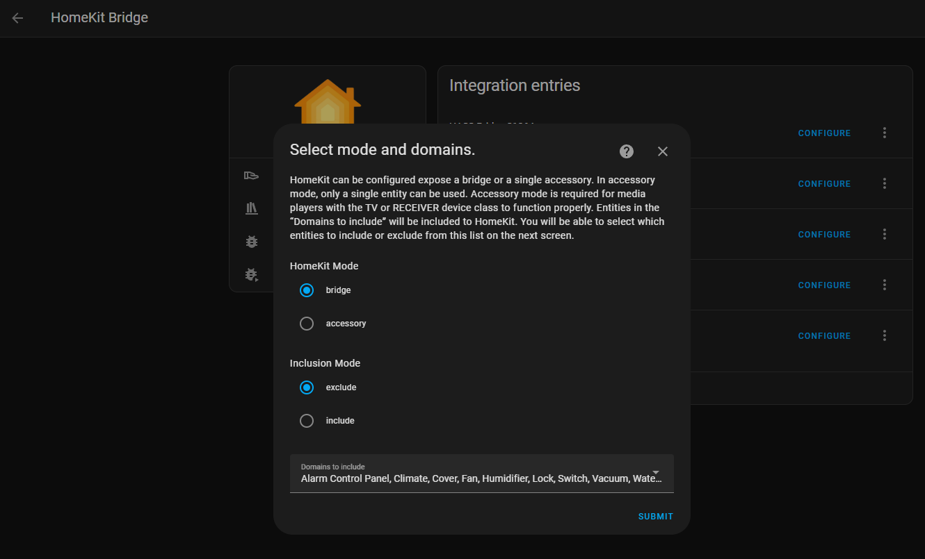

I figured it out. Clicking on configure, it opens a new menu that was not available for me before, where i can chose inclusion or exlusion mode.
Selecting “exclude” and no device in the next screen makes every device appear on Apple Home App without any added configuration. Then, its just a matter of putting the devices in the right division. Thank you a lot.
