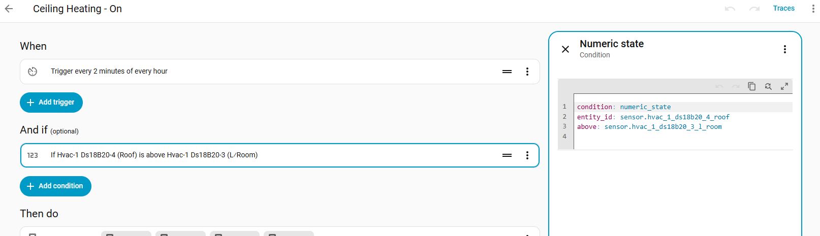

Automation is to turn on a Fan & Open HVAC Dampers when Roof Temp is 2°C above Lounge Room them.
AI seems to be sending me down all the wrong roads.
This is the basic example, & is it possible in the YAML to add 2 to the above: value?
As in sensor.hvac_1_ds18b20_3_l_room + 2 .
Have tried a few things in the Developers tools, but can't get a valid entry for the GUI Yaml.

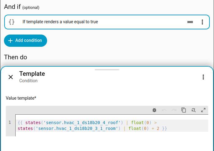

For your application, I suggest you use a Template Condition.
condition: template
value_template: "{{ states('sensor.hvac_1_ds18b20_4_roof') | float(0) > states('sensor.hvac_1_ds18b20_3_1_room') | float(0) + 2 }}"
How it works
  • states() is a function that gets the state value of a given entity_id.
  • An entity's state value is always a string, even when it appears to be a number. If we intend to use it to perform arithmetic, or compare it to another number, we need to convert it from a numeric string to an actual number.
  • float() is a function that converts a numeric string into a floating-point number. There's a similar function named int() for converting numeric strings into integers.
  • The zero in float(0) is a default value. If float cannot convert a string into a number, for example the entity's value is the string unavailable, it will report the default value which, in this case, will be zero. You can set the default value to whatever is best for your application.

Thanks,
I found both Example to work in reverse to what I expected.
But that turn out to be a Typo in both examples above.
The Entity:-
has a lower case "L" before the "_room"; Short for Lounge Room.
So correct Entities are:-
condition: template
value_template: "{{ states('sensor.hvac_1_ds18b20_4_roof') | float(0) > states('sensor.hvac_1_ds18b20_3_l_room') | float(0) + 2 }}"
Thanks for the Prompt & Well Detailed Replies.
