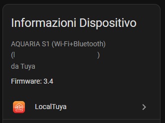

Looks like 3.4 FW version needs to be used now.

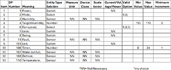

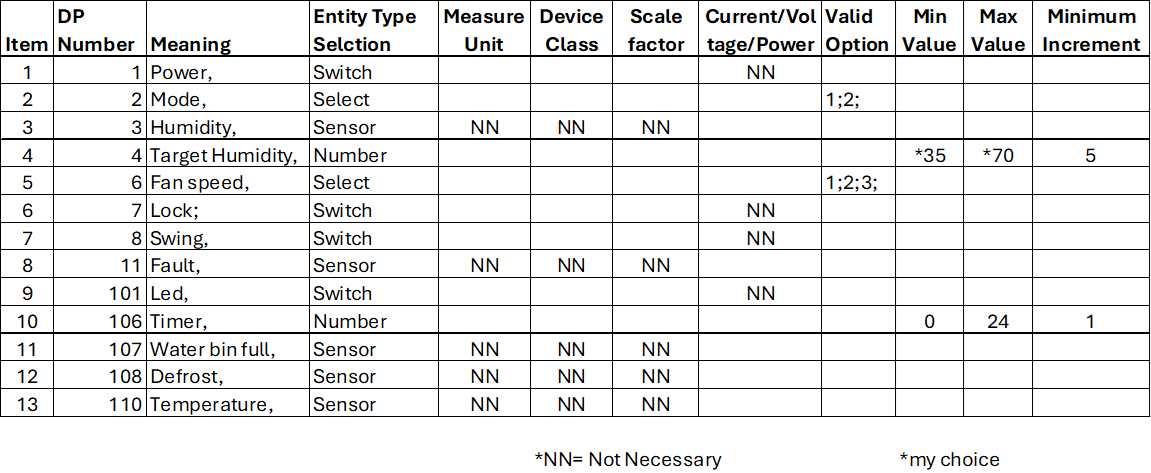

Hello everyone, and thank you for your contributions.
I hope to help you by posting some information for the complete integration of the Olimpia Splendid Aquaria S1 dehumidifier.
The integration was done using LocalTuya and acquiring/managing all the available parameters.
A direct integration achieves (almost) nothing.
The result:

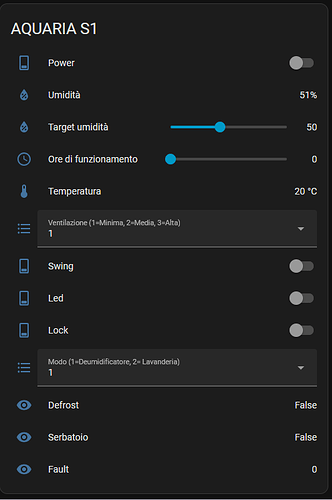

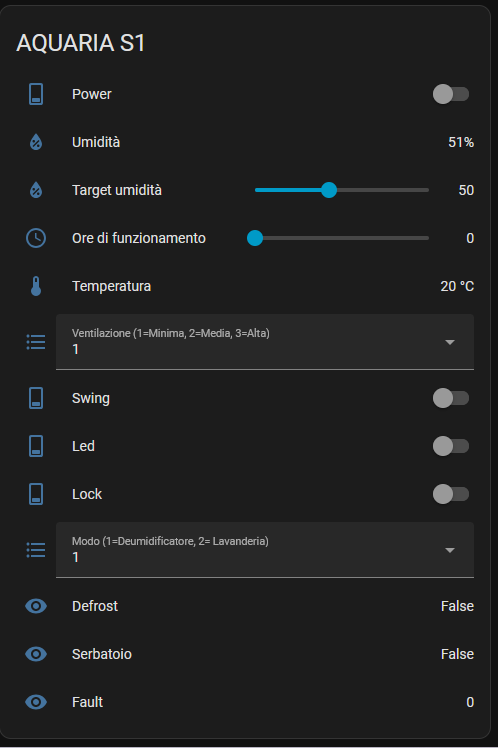

The correct (and working) way to select and set the different entities:

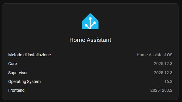

My environment:
Remember to uncheck “Show header toggle”…it’s not nice to look at and not useful.
