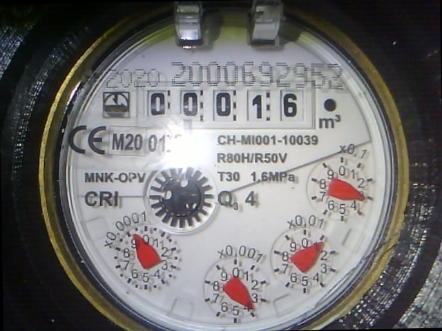

1st Test:
curl -s -X POST <HAOS-IP>:5000/segment -F "identifier=watermeter" -F "[email protected]"
{"identifier":"watermeter","results":[
{"id":"d1","value":"00016.0"},
{"id":"a1","value":9.127448058121708},
{"id":"a2","value":3.881748198574262},
{"id":"a3","value":1.2311287412814798},
{"id":"a4","value":3.345734090629815},
{"id":"t1","value":"CH-MI001-10039"}]}
