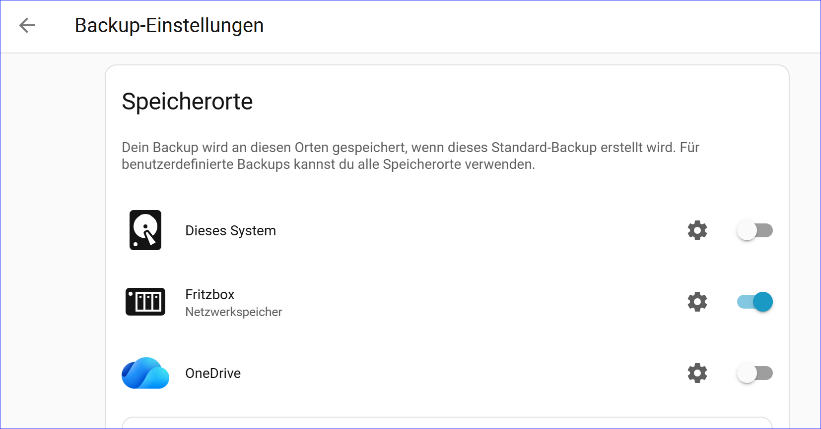

I have defined a network drive for HA to store its automatic backups.
HA is correctly storing its data on that drive. However, add-on updates are backed up only locally.
Am I missing a setting or is this HA not doing the job right? ![]()

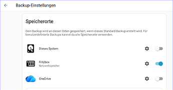

You need to go to ‘configure backup settings’ > top right 3 buttons > ‘change default action location’.
Here you can select where to backup by default. Is this showing the remote network location as the default?
That was fast, many thanks!
Would not have expected that there is an additional setting for ‘standard’, given the main UI dialogue. ![]()
