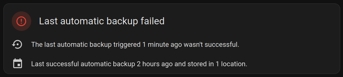

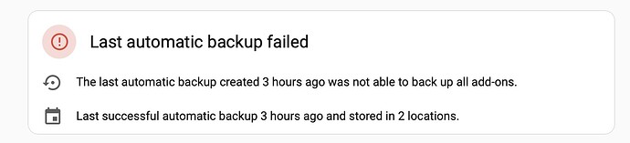

My HA installation has been saving a daily backup to my Raspberry Pi and NAS without issue until last week when I got the following error message which has occurred ever since.
Please can anyone advise what the issue may be. I am also a bit confused since one sentence seems to suggest the backup was successful while the other sentence suggests it wasn't.
