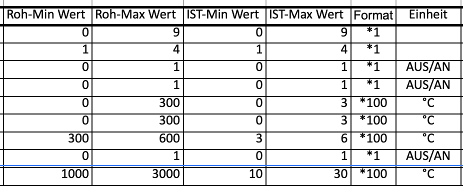

  2. The sensor “Proxon Heizelement Status”
    This sensor (register) is always 0, no matter which Heizelement is on or off. In the Excel-File I found “Heizmodul 2 Relais Status” at address 583. This one is always 7 :weary:
    Finally I’m not able to see the status of the Heizelemente via the templates :man_shrugging:

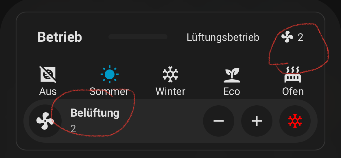

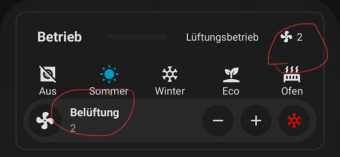

Only one thing I’ve noticed is, that when Proxon is in ECO Comfort mode, the “current ventilation level” on modbus address 4x0022 might not line up with the actual ventilation level that is shown on the “splash screen” of the Proxon Control App. (e.g. Current Ventilation Level is locked at 3, while it might go up to 4 if intensive ventilation is going on or it might drop lower when target temperatures are reached).
Does anyone have an idea here? Seems like eX2x has noticed the same Problem…
Great! I also don’t think that anyone will take it completely over. But it helps as a starting point I think.
I am not sure, but i am already using two types of fan status. One is the status message of the fan setting (control) and the other one is the current fan value.
In the screenshot you can see both. Left of the setting and the upper right corner the current status.
It is possible, that the setting ist 2, but the current fan value is 4 due to e.g. climate is on.
Was that your question?
BTW: I am currently on vacation. I will try to answer also the other questions when I am back at home.

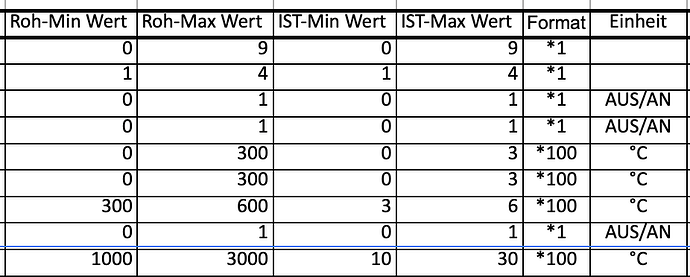

Hallo,
Ich nutze HA in Verbindung mit einer Proxon P2 und versuche diese step by step in HA zu integrieren. Beim setzen der Solltemperatur fürs Wohnzimmer
komme ich aber nicht weiter. Ich habe eine numerische Eingabe angelegt + eine Automatisierung, die bei Änderung der Eingabe den aktuellen Wert dann
per Modus in die P2 schreiben soll (Solltemperatur Wohnzimmer ist die Adresse 70).
input_number.temp_wz_eingabe - ist eine numerische Eingabe als Helfer
mit folgender Automation:
alias: WZ Temp SOLL setzen
description: “”
triggers:
  • entity_id:
    - input_number.temp_wz_eingabe
    trigger: state
    conditions:
    actions:
    - data:
    slave: 41
    address: 70
    value: “{{ states(‘input_number.temp_wz_eingabe’) | int }}”
    hub: proxon
    action: modbus.write_register
    mode: single
Der Wert ändert sich aber nicht in der P2.
Könnt ihr mir bitte weiterhelfen, wie ich das Register 70 beschreiben muss, damit der Wert sich ändert ?
Danke
Thanks. You are right … Copy/Paste error :wink:
Hallo @knoxilein,
hast du den Wert *100 genommen?
Sp steht es in der Liste von Proxon (siehe unten rechts → Format = *100)
