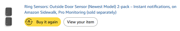

Are you sure it's the Z-Wave version? The newest version is not, it uses Amazon Sidewalk (wifi).
I think this may have been my issue all along looking at my order history:
I will try purchasing the same sensors on Ebay to see if I have better luck there- will report back after testing.
It would appear that the newer version of the Ring Sensors (mine said "new" in the listing) do NOT support Z-Wave as you mentioned.
I purchased an older version on Ebay and can confirm I can add them as if they were regular contact sensors.@vco2000
