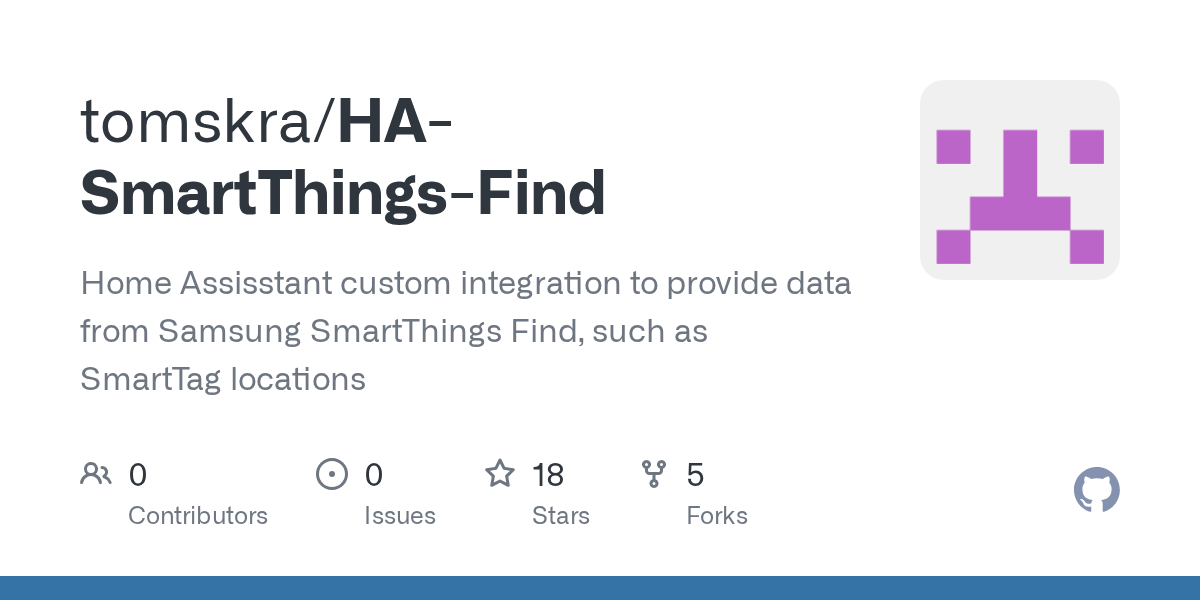

I tried to install this fork and got errors right at the start… Does this still work for you? How did you generate the code needed in the configuration?
I was able to redownload and reinstall. The jsessionid source is described in GitHub, not sure what I can add to it to help.

My smarttag devices now don’t show up in smarttingsfind.samsung.com at all. They only show up in samsungfind.samsung.com. They don’t show up in the tomskra fork of the smartthings find intergration. In uTag, this problem along with the JSESIONID lifetime issues don’t exsist. I have very limited knowledge about coding, but I do have a feeling some things could be learnt from uTag.
I’m working on the new integration for SamsungFind web. But I don’t have enough time for finishing it.

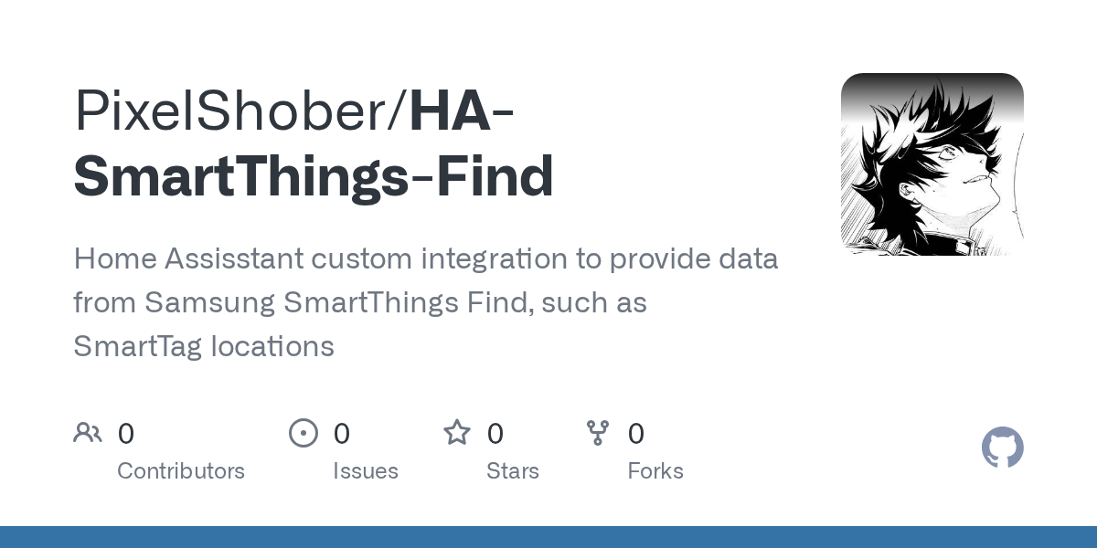

Hey guys,
I published a new SmartThings Tag integration for Home Assistant, inspired by @tomskra’s repo. It works the same way as U-Tag and uses the API instead of a JSessionID.
You can also start & stop the ring function over this.
Currently, only tags are supported.

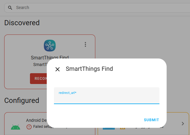

Hi, installed and got to the dev tool… question about the URL after ms-app.
should I copy from right before ms: (‘) to end (’)? or portion/bolded below? didnt work! not sure what I need to use.
edited for security reasons:
body onload=“window.location.href=‘ms-app://bbbbbbbbbbuuuuuuuuuuunnnnnnnnchhhhhhhhhhhhh-of-numbers?code=some_code&api_server_url=some_api_number&auth_server_url=some_number&retValue=some_value&code_expires_in=300&state=some_state_number&status=new’;”>
Ok, so I figured out by mistake. I double clicked the line that had the ms-app, and it selected a partial part of the code on its own. That did the trick.
