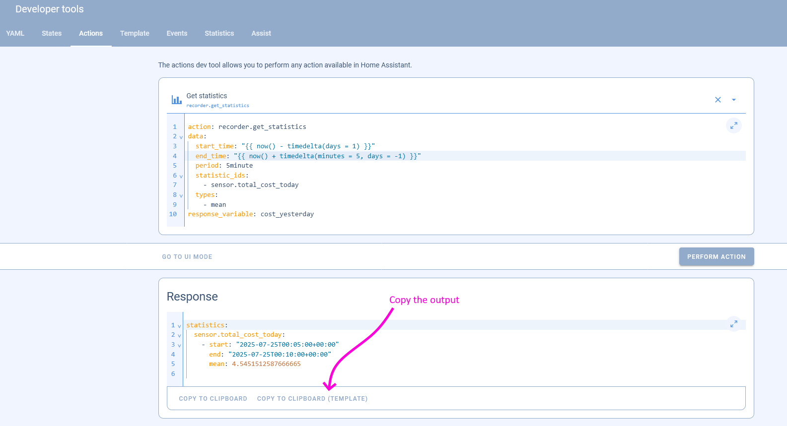

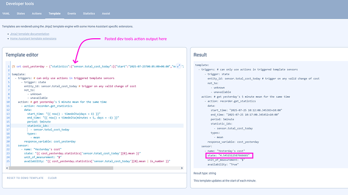

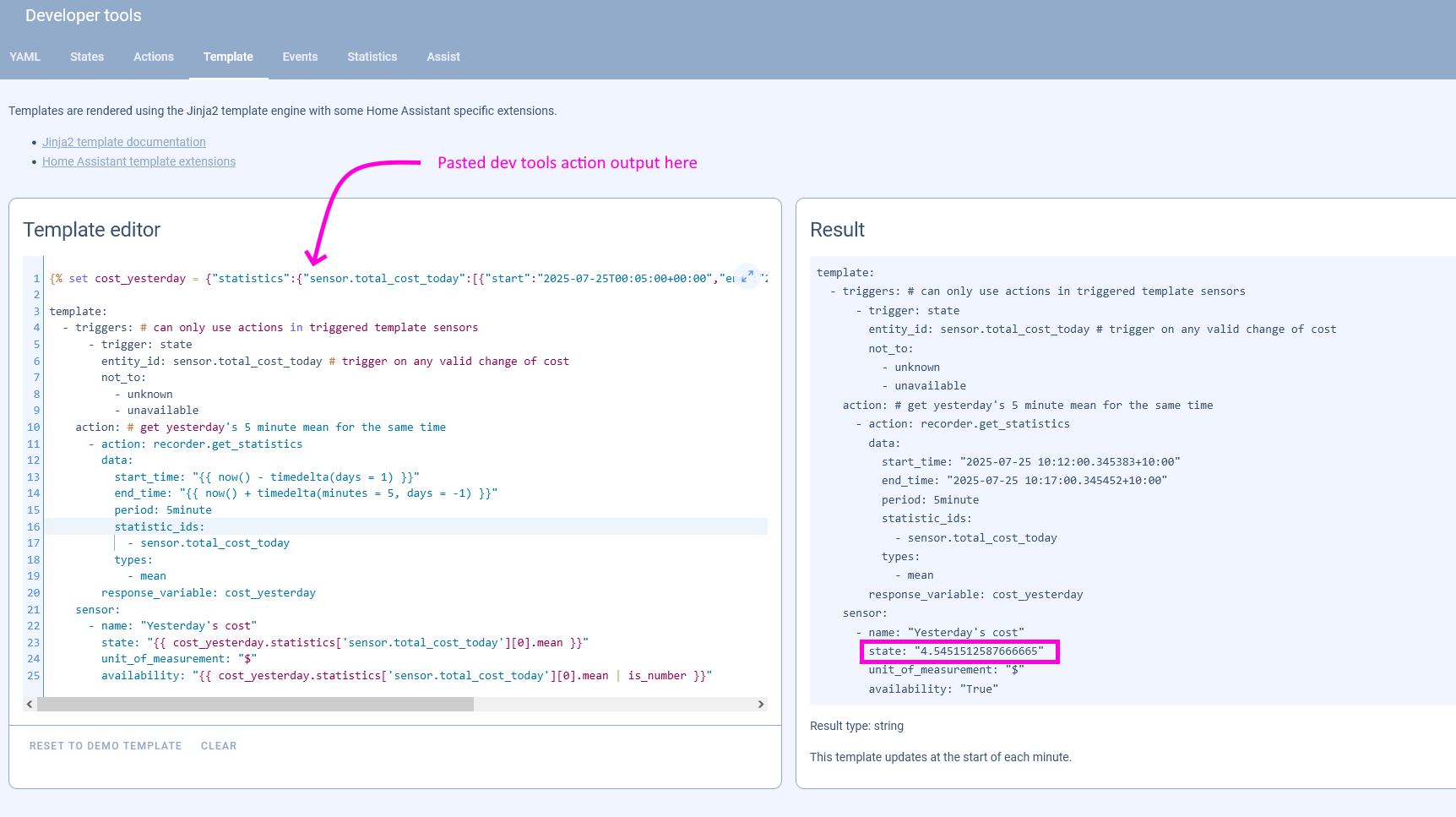

Here is an example that should get the five minute average one day ago for my energy cost sensor:
template:
  - triggers: # can only use actions in triggered template sensors
      - trigger: state
        entity_id: sensor.total_cost_today # trigger on any valid change of cost
        not_to:
          - unknown
          - unavailable
    action: # get yesterday's 5 minute mean for the same time
      - action: recorder.get_statistics
          start_time: "{{ now() - timedelta(days = 1) }}"
          end_time: "{{ now() + timedelta(minutes = 5, days = -1) }}"
          period: 5minute
          statistic_ids:
            - sensor.total_cost_today
          types:
            - mean
        response_variable: cost_yesterday
    sensor:
      - name: "Yesterday's cost"
        state: "{{ cost_yesterday.statistics['sensor.total_cost_today'][0].mean }}"
        unit_of_measurement: "$"
        availability: "{{ cost_yesterday.statistics['sensor.total_cost_today'][0].mean | is_number }}"
Only tested in the template editor.
Edit: As confirmation I actually use an SQL sensor to get the state data yesterday and this is what is says:
One cent off the 5 minute average. That seems reasonable as the cost would be increasing for the rest of the 5 minute period.
