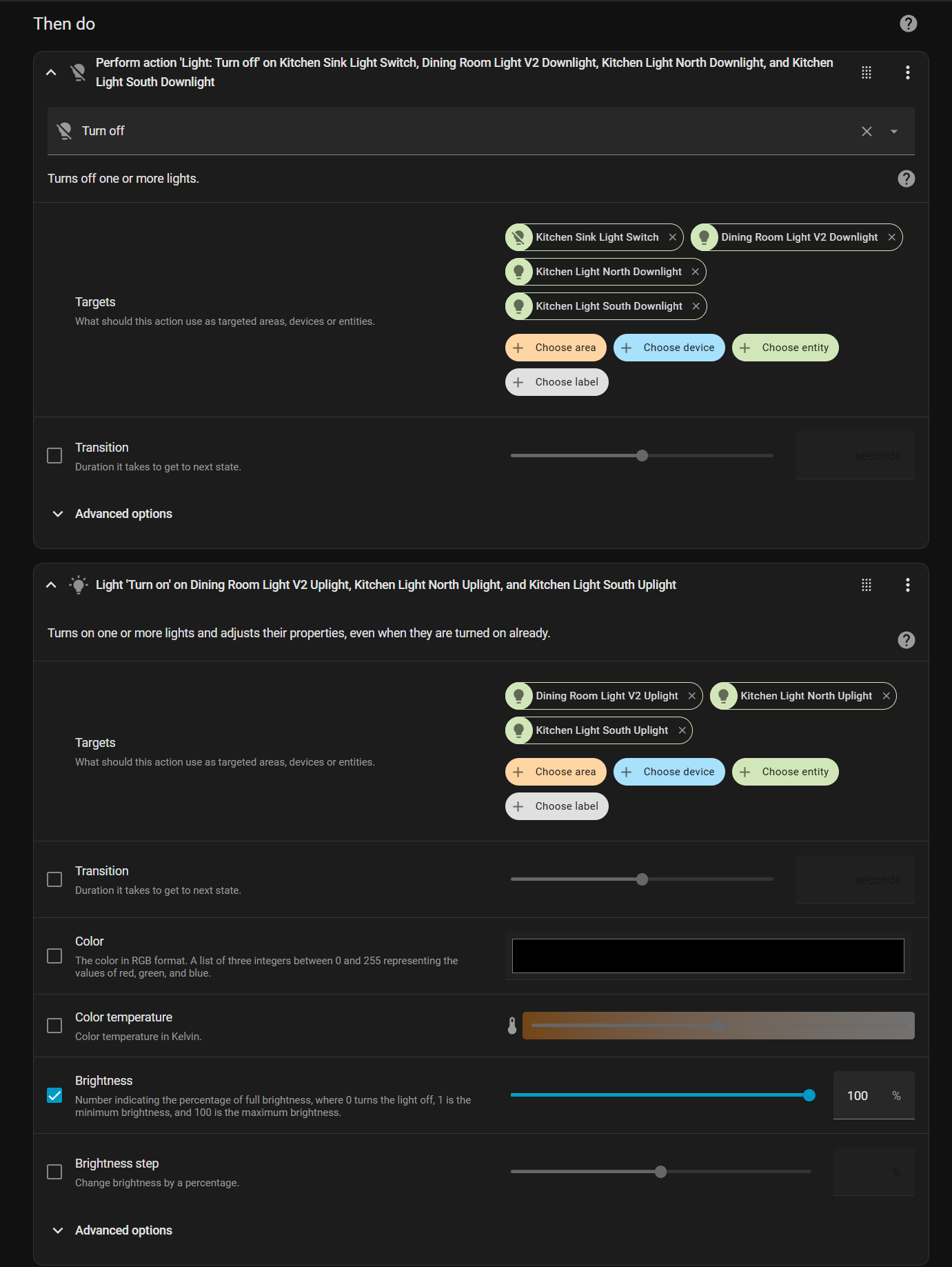

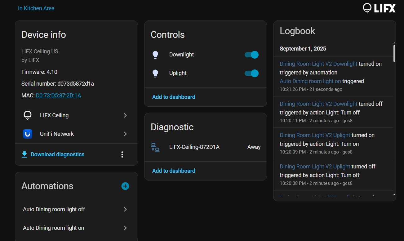

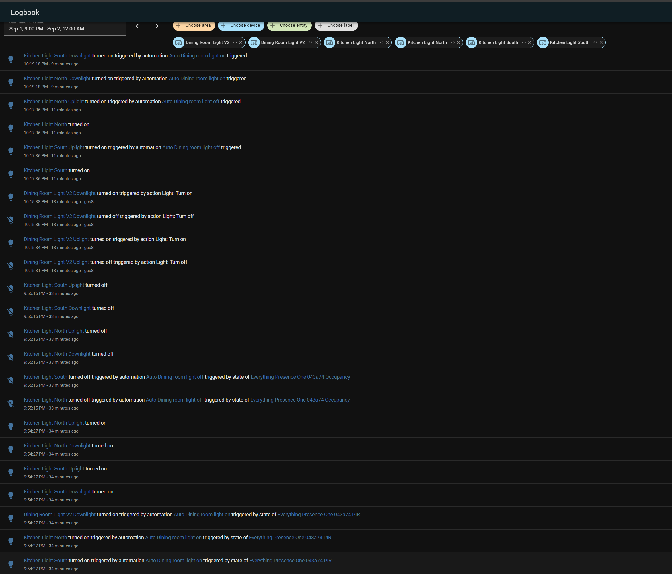

I think we have a race condition or something. I noticed that having a mix of the ceiling and the ceiling 13x26", or the brightness on the uplight causes the downlight to come on/stay on from time to time from this automation.
Yeah, you need to give Home Assistant at least 10 seconds to notice a change in the uplight or downlight as it relies on the core LIFX integration to do the actual polling. I did it this way so that I don’t place extra stress by sending more requests to each device.
So I am holding it wrong, lol. I disabled the 2nd call for now, it’s more of a desired state than a force state? If I am describing that right.
Not quite: it is a forced state but it realies on the core LIFX integration to determine what the current state is.

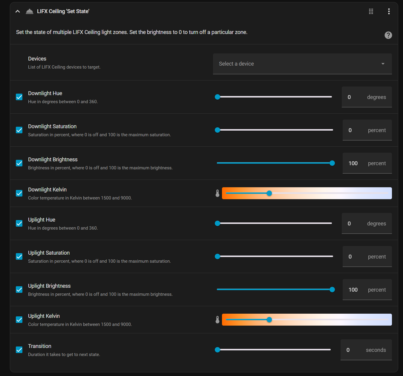

In this particular instance, you should use lifx_ceiling.set_state action to adjust the uplight and downlighnt state instead of the more generic light.turn_off and light.turn_on actions. This will ensure that Home Assistant is immediately aware of the actual state of the individual zones on each of your Ceiling lights.

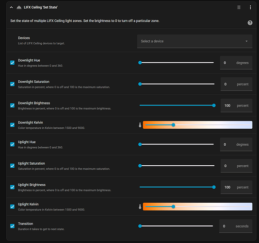

I would, but it doesn’t see the stuff under LIFX Ceiling.
Are you sure you’re selecting lifx_ceiling.set_state? This is a different action to lifx.set_state.
ohhhh, you mean this? If so, yeah, I was just using what the UI bubbled up and scrolled the list and it did not show till I started typing ceiling, or I need new glasses.
hmmm, takes quite a bit to return 7-8 celing lights when searching for ones to add, few sec before it even shows you a list. It also seems if you uncheck the set kelvin on it, instead of it just changing the brightness and using the current setting, it make it the much softer orange light vs the cracked out 9K I seem to like.
Interesting. I have 4 Ceiling lights and the list is instantaneously populated for me.
As for unsetting the kelvin value: it should retain the current value if the zone is currently on, i.e. if the light is on and the brightness of the zone is greater than zero.
However, due to the way in which LIFX implemented the zones, it is often impossible to determine what the color (or color temperature) should be so I default to using 3500K. This default value is documented: GitHub - Djelibeybi/hass-lifx-ceiling: Provides uplight and downlight control for LIFX Ceiling in Home Assistant
My recommendation is to specify all the values so that the integration doesn’t need to try and work it out or use the default.
