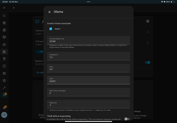

As I think this isn’t going to be fixed any time soon I’ve made a python script that’ll patch the relevant Ollama integration files so you can control the Temp, Top_p and Seed for any Ollama instance. It’s got some default settings that you can change before implementing and make sure you backup the files in /usr/src/homeassistant/homeassistant/components/ollama before you run it. NB. needs to be run from within the homeassistant docker instance - if you don’t know how to do that then find that out first.
Anyhoo I can now set Temp, Top_p and Seed in the UI for any ollama agent. Let me know if you need the code or any help getting it working.

Sure - you’ll need the Advanced SSH & Web Terminal installed. Copy the python script to /config/patch_ollama.py and in the terminal run ‘docker exec -it homeassistant /bin/bash’ to get to the shell of the home assistant docker image.
Once in the shell and in the /config folder run:
python ./patch_ollama.py
The script will create a backup of the files affected but I’d suggest doing a full backup beforehand just in case. NB. this is unofficial code, comes with no warranty and needs to be run after every Home Assistant upgrade. That said, it appears to be working for me.
You can modify the script to change the default values to your liking - the settings here are generic.
