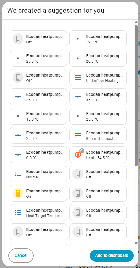

Hello, I added an awesome ESPHome device for my heatpump with a lot of options.

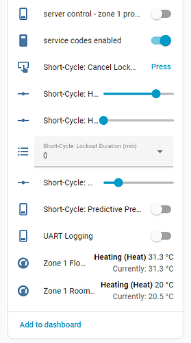

If I go to settings of the device, I see a nice identity list, with on the bottom “Add to dashboard”.

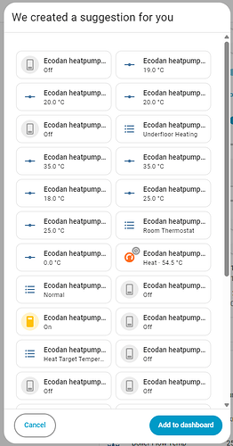

If I click it and select the dashboard I want, then it suggests an awful looking thing, which I cannot opt out off.
Anyone any idea how I can add the list of identities just as in the device overview?
I know I can recreate it, but that is a lot of manual clicking…

hello,
Add to dashboard Entities card
Add each entity you want to view and you should have exactly the same.
