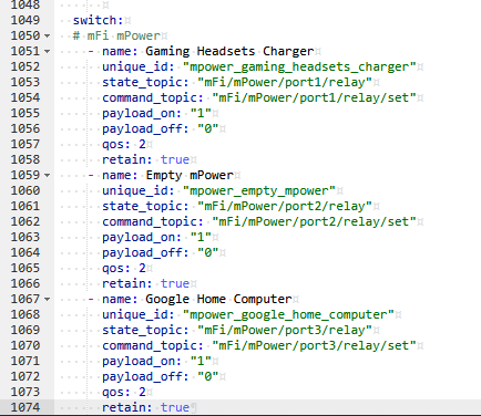

I need to add another mqtt switch, I added, the file looks like this
switch:
  # mFi mPower
  - name: Gaming Headsets Charger
    unique_id: "mpower_gaming_headsets_charger"
    state_topic: "mFi/mPower/port1/relay"
    command_topic: "mFi/mPower/port1/relay/set"
    payload_on: "1"
    payload_off: "0"
    qos: 2
    retain: true
  - name: Empty mPower
    unique_id: "mpower_empty_mpower"
    state_topic: "mFi/mPower/port2/relay"
    command_topic: "mFi/mPower/port2/relay/set"
    payload_on: "1"
    payload_off: "0"
    qos: 2
    retain: true
  - name: Google Home Computer
    unique_id: "mpower_google_home_computer"
    state_topic: "mFi/mPower/port3/relay"
    command_topic: "mFi/mPower/port3/relay/set"
    payload_on: "1"
    payload_off: "0"
    qos: 2
    retain: true
I have restarted home assistant, the new entity does not show up…
I am missing something?
Clear cache or using another browser, does not solve the issue
Thanks!

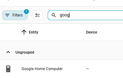

I will do a test now, writing directly to configuration.yaml…
Guess, what? :smiley: directly to configuration.yaml, works
My question now is:
how can I add all the switches into one file and all the sensors to another files, what I need to use for include, to include all the yaml files of mqtt, from one single folder? No matter if is switch of sensor, having them in separate files
I don’t understand how is the split configuration for mqtt…
Ok, I did it, finally. It was because of the split configuration, of course…
Thanks!
