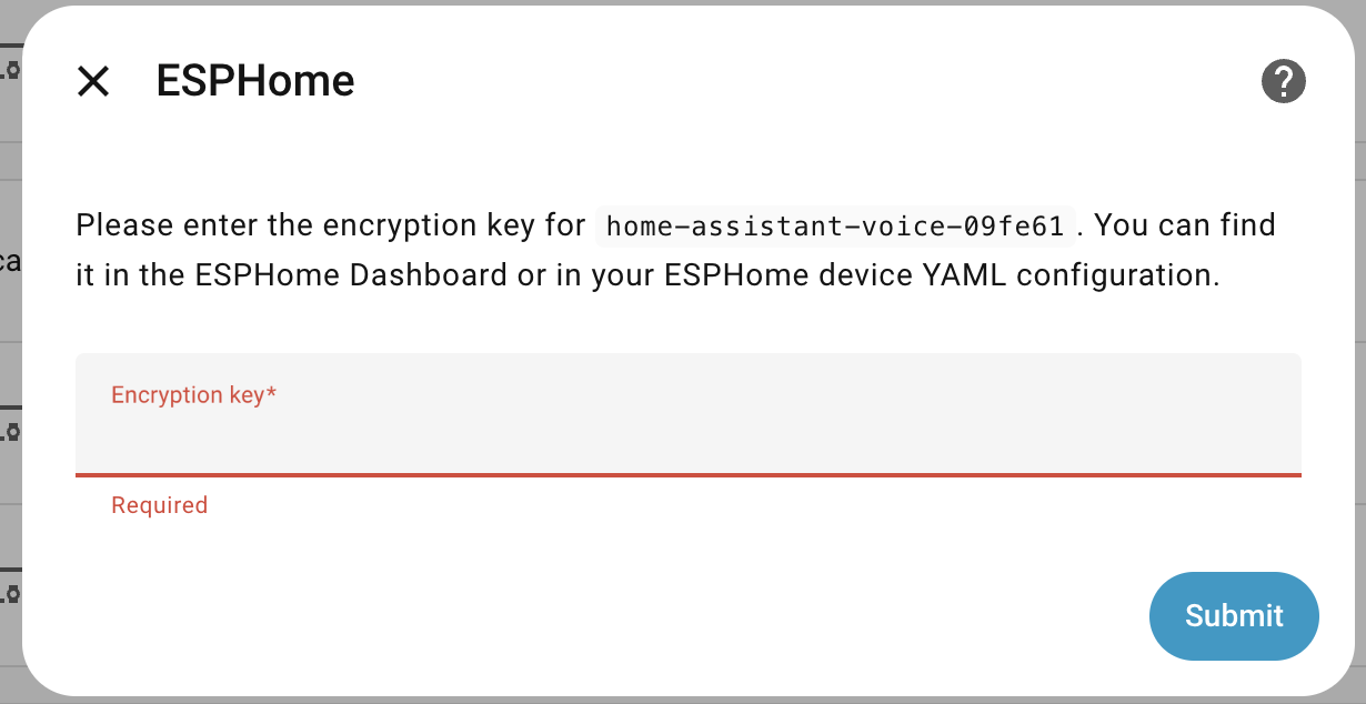

As per the title, I have a Voice PE device that is accessible via VPN, can be pinged etc etc etc.
When I add the device and provide the IP Address I am prompted to enter the encryption key, but I cannot find that anywhere or any settings menu to display it.
Any suggestions ??
I found a key in the .storeage → esphome devices but that does not work, and I am guessing that is just the device ID and not the encryption key ?

Dave, how did you add it, I have tried adding it while using the OSX companion app, but still get prompted for the key.
I added it by using the ESP Home integration add device and entering the IP address of the PE Voice which is on another subnet and remote.
Then prompted to enter the key.
I used the Android companion app. After telling it what wifi credentials to use it sorted the rest out for me.
