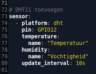

So far, I’m using ‘esphome’ from the CLI to prepare my ESP32. I’ve succesfully added a switch to turn on the on-board LED. But when I try to add a DHT11 sensor to the file:
Compiling & transferring this using the the command:
‘esphome run ~/config/huiswerk.yaml’ gives me - after 15 to 75s) - the following error:

Gpio12is strapping pin, boot fails if pulled up (needed for dht ).
Try some pin 16-33 for example…
And that influences the compilation of the yaml-file?
Absolutely not, just a side note.
Perhaps you get better support for your problem here if you post your code and logs using code tags instead of tiny screenshot.
I already had ‘random’ errors at compiling; it’s always a good idea to clean the build files before starting over.
Hey man, just a couple things first. Please dont upload screenshots of your code/config! There are a couple of different ways to insert code so that it automatically uses the correcy syntax and alignment so people can actually see it and be able to help you!
