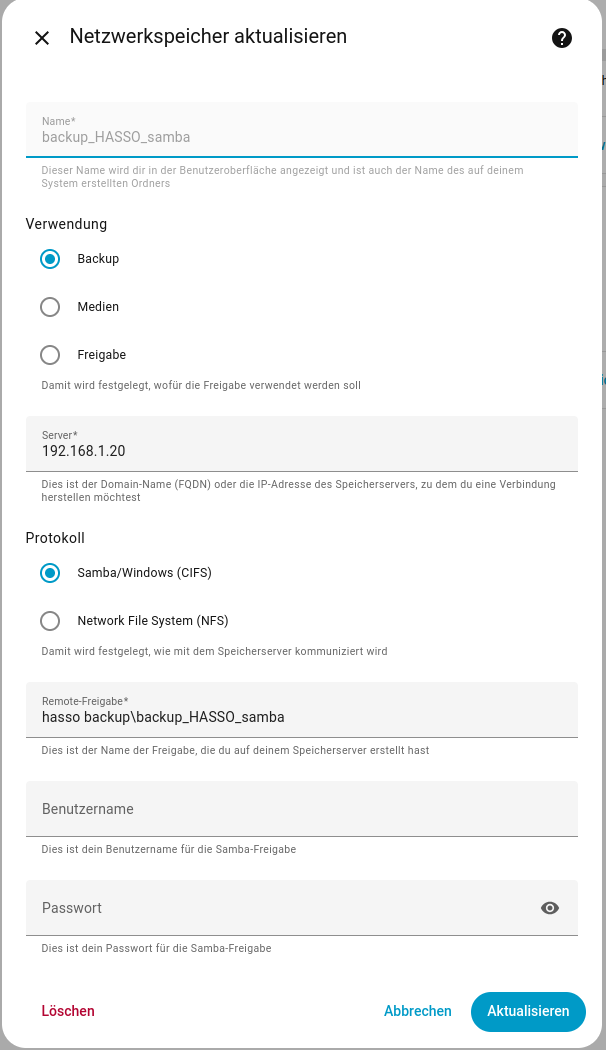

However when I try to configure the network storage, I keep getting an error. Here is what I am trying to configure the network storage as…

HASSIO108 is neither a Fully Qualified Domain Name nor an IP address. Is this your share name?
192.168… is not a share name. Is this the IP of the share host?
A local drive on the host computer, like a thumbdrive is not a network share.
You can use Samba Share to copy the /backups directory to another computer.
always when I have to build HA from scratch, I’m driving nuts because of the network-share-settings.
maybe it helps others as well.
