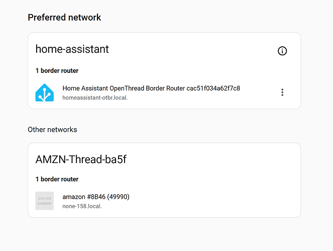

I have a related question. I use a Sonoff Dongle for Thread and it works fine.
However in the Thread Integration it shows Amazon as a second available Thread router. How do add this / make it work ?
Adding more Border Routers is not recommended to stabilise a Thread Mesh. Especially when you mix up different brands (Amazon/Apple and so on) it could even destabilise everything if the border routers don't perfectly work together. Another border router only adds some kind of redundancy to the system in case the first border router goes up in flames or something...

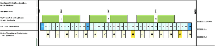

You should also have a look at your WiFi Settings (2,4Ghz) and make sure that your Thread radio channel doesn't overlap or interfere with WiFi.

Wifi is on channels 5,6 and 11. Thread is on channel 25
