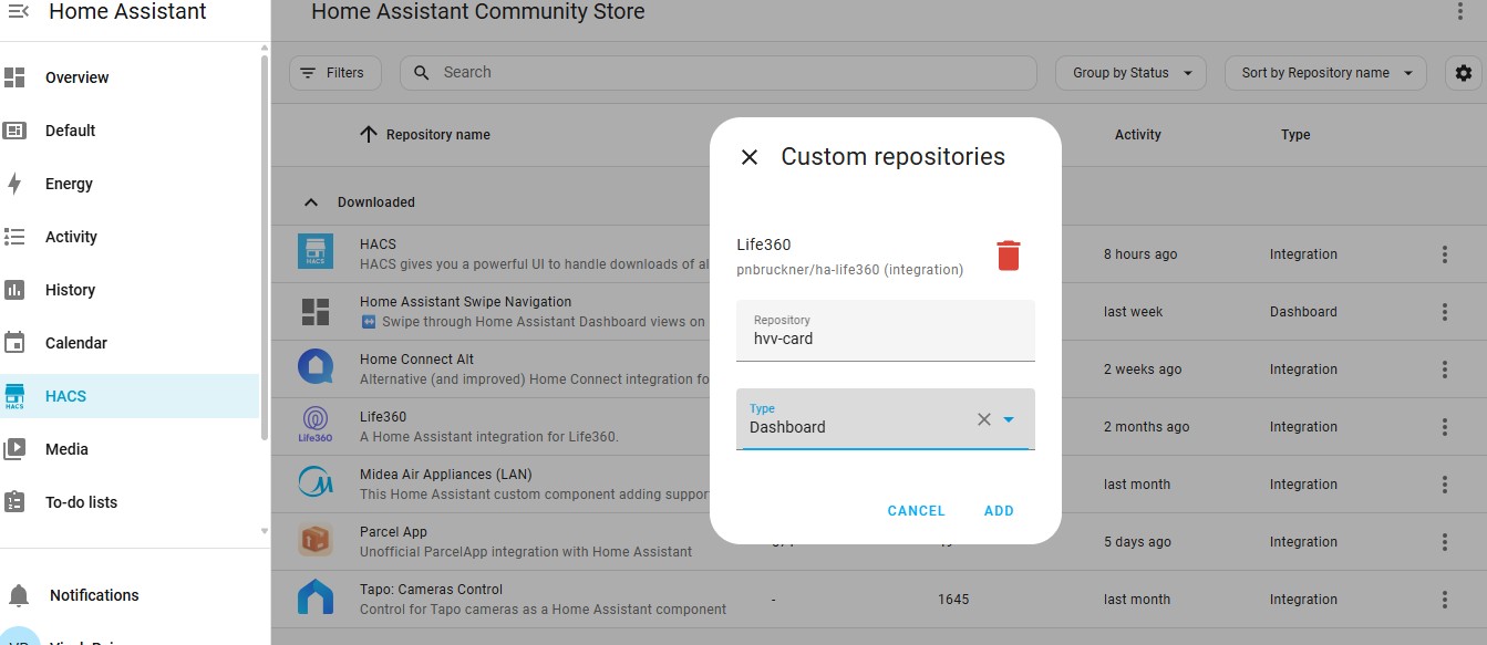

Hi, ok. I’ll share screenshots once I’m back home. But in this case the pop up screen on which I click on “add” just stays open. I have to manually cancel that screen to exit because nothing happens. And I see nothing to download.

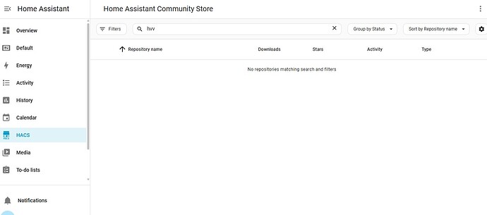

Here are the screenshots.
It seems the add button is not doing anything. and the card cannot be found as well.
Is this some kind of general bug, or something specific to my set-up, or just me doing ‘junior artist’ things… me wondering…

You are not using the full https link in the repository field … look at my example above on what to use
EDIT:
the ‘custom’ add means that you will add an external repository to the list of HACS repositories, hence it needs the full url
aah… wow. how simple it was , how silly i was. smiling and cursing at once. thanks a lot for that. now i see how hacs reacts once we add the right thing… thanks again.
