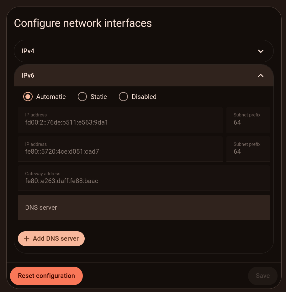

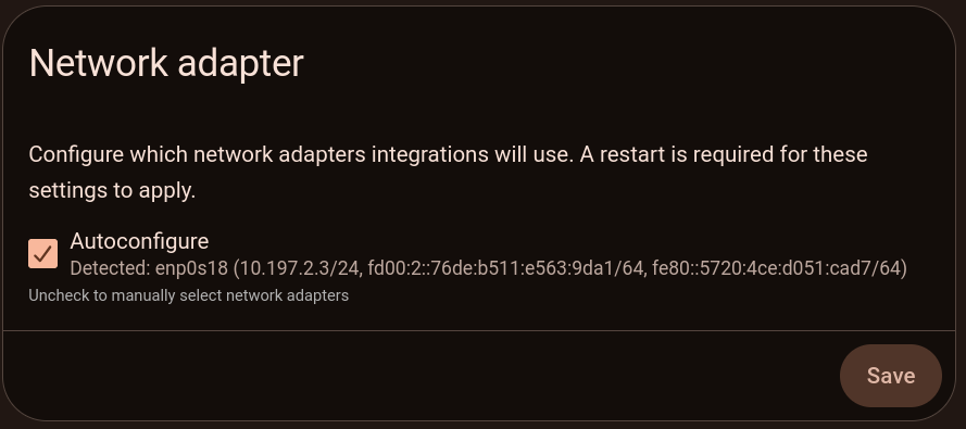

    IPv6 enabled and set to Auto in the HA settings:

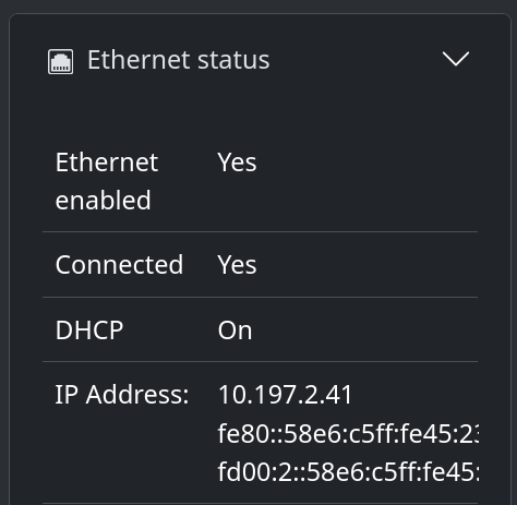

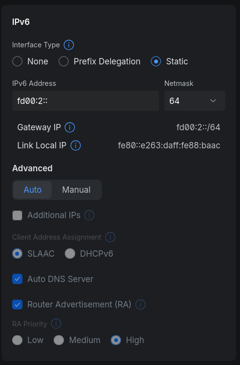

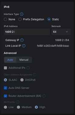

    • HomeAssistant server, and OTBR have IPv6 enabled: Network with VLAN 2 for smart devices has dedicated SSID and IPv6 set to Static with fd00:2::/64, SLAAC enabled, Auto DNS Server, RA enabled and set to high

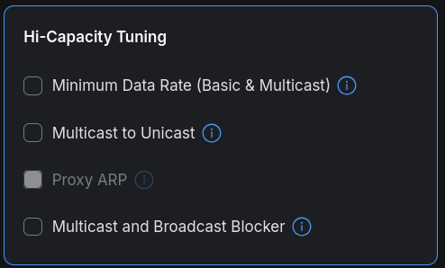

    • Wifi network set to 2.4 GHz only with Multicast limits etc. set to off

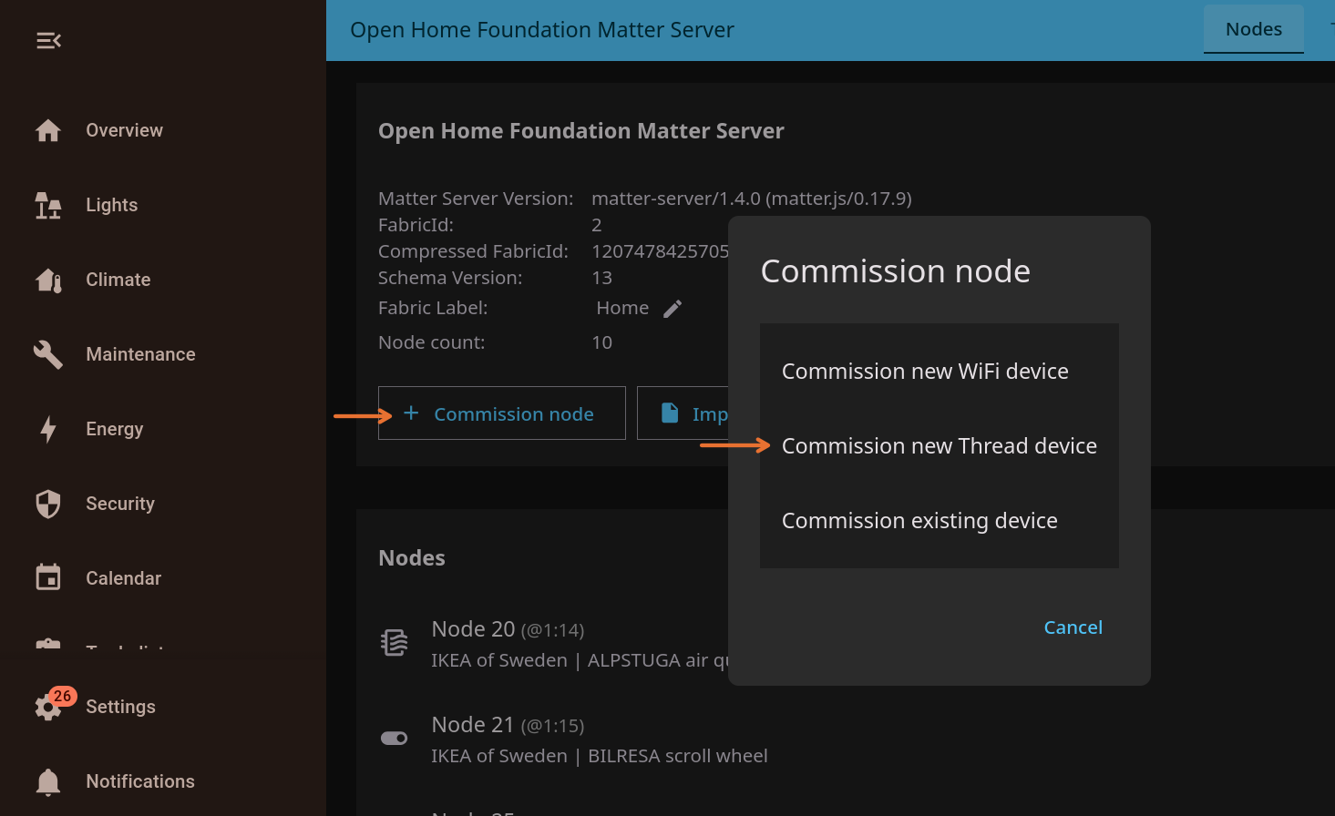

Direct commissioning

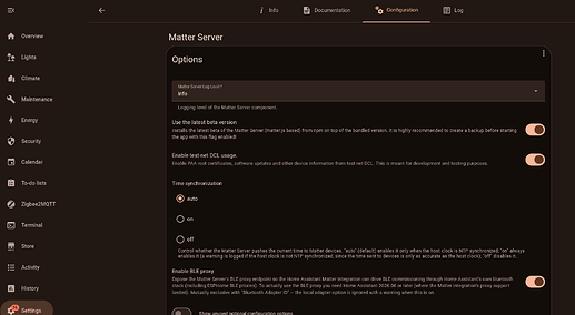

Regarding the commissioning directly via Bluetooth on the HA server; Most threads recommend connecting a bluetooth dongle, leaving it unconfigured, and noting down the ID to configure the matter app with it. This seems deprecated as the option is now specifically listed as such with the BLE proxy option being the new way of doing it.

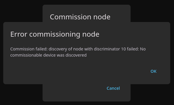

I have tried this as well: I have both Bluetooth proxies via Shelly Plus Plug S in my home as well as a local USB bluetooth dongle connected to HomeAssistant that I’ve left unconfigured.
Matter and Wifi settings are configured.
  • Set IKEA device to pairing mode / reset by holding down button until countdown appears and LED flashes red.
  • Placed device directly next to USB bluetooth dongle (<1m)
(Note: This did not work! See below for the deprecated second attempt!)

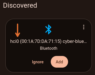

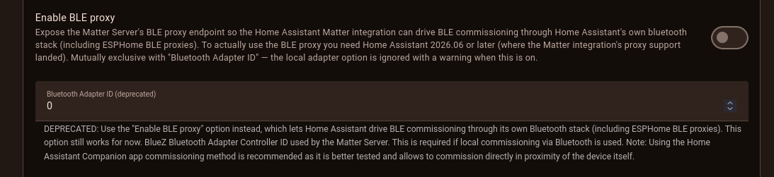

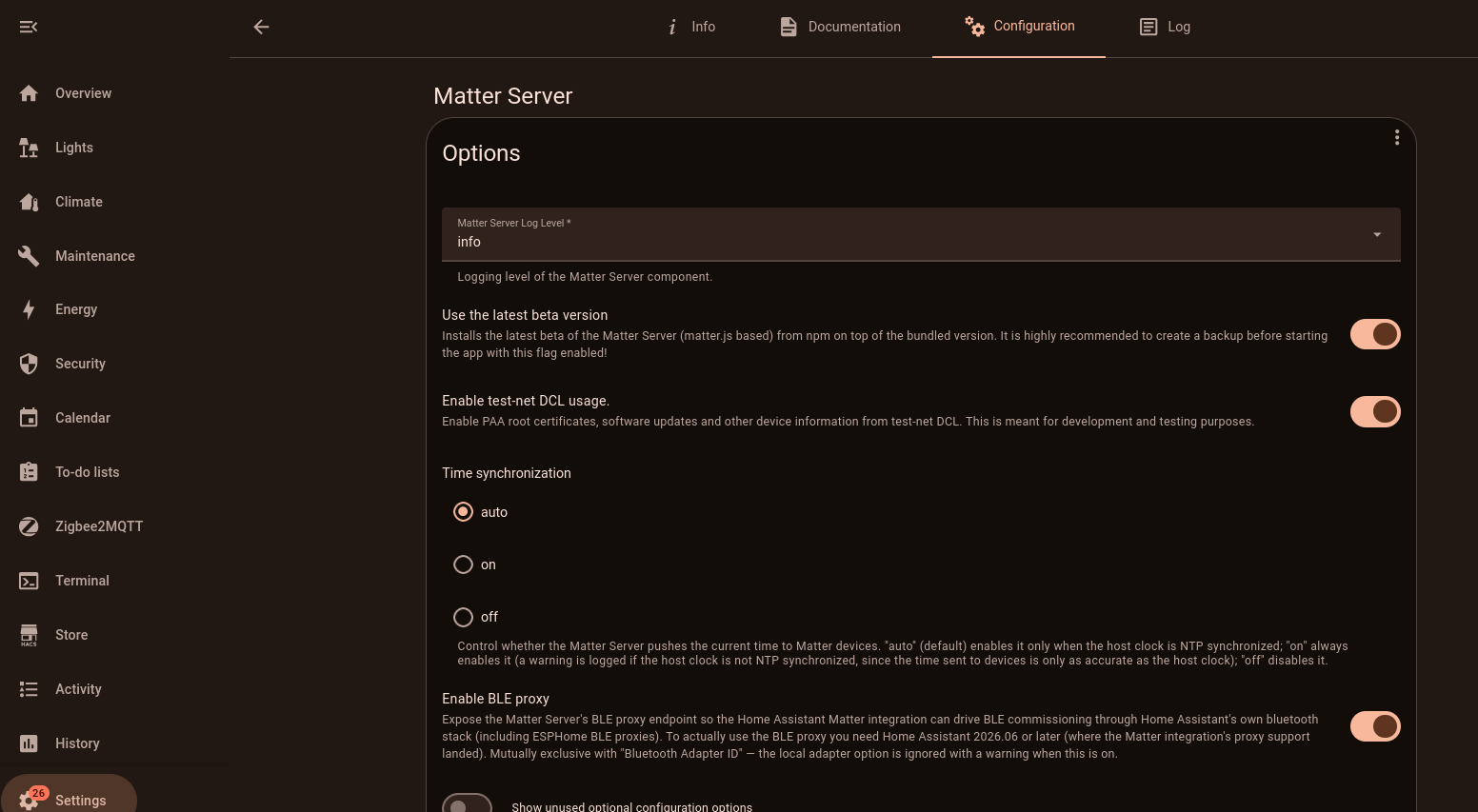

Second attempt: “Deprecated” way - This worked!
Noted down ID (=0) and left device unadded/unconfigured
Set Bluetooth adapter ID in Matter App configuration:
Restarted Matter server as prompted

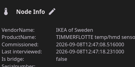

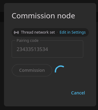

Same process as above, enter pairing code, wait, DONE!
