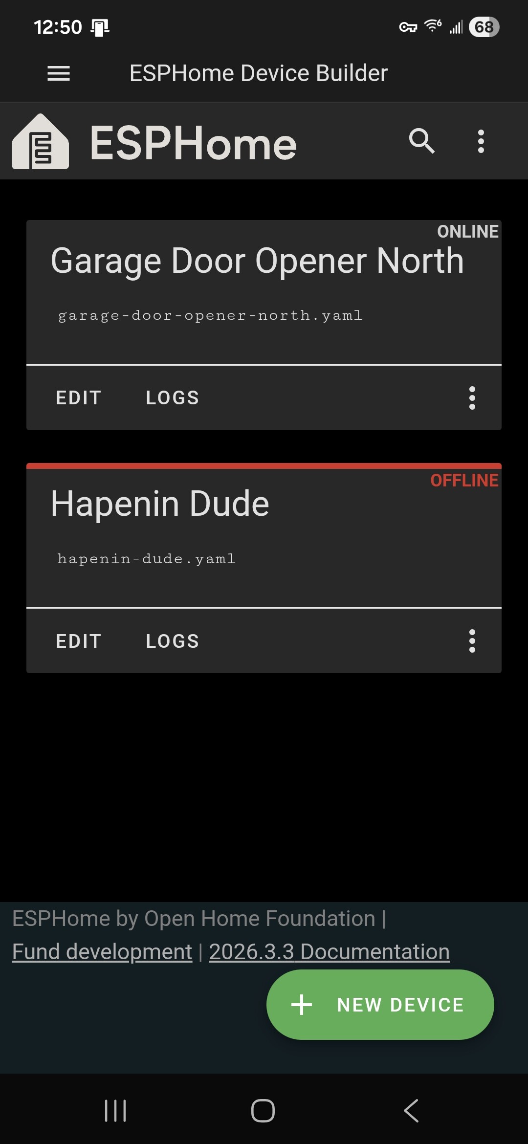

One thing I don’t understand which may be the issue is that in ESPHome builder, it shows an instance of my wifi network, but the SSID is incorrect. It is showing off line, but is it even necessary? Under secret, it has the correct SSID and password.

This is the ESPHome Device Builder Log. Is that the best one to post?

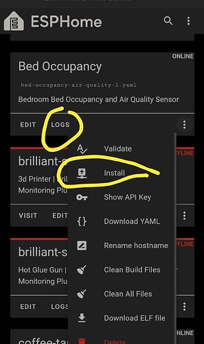

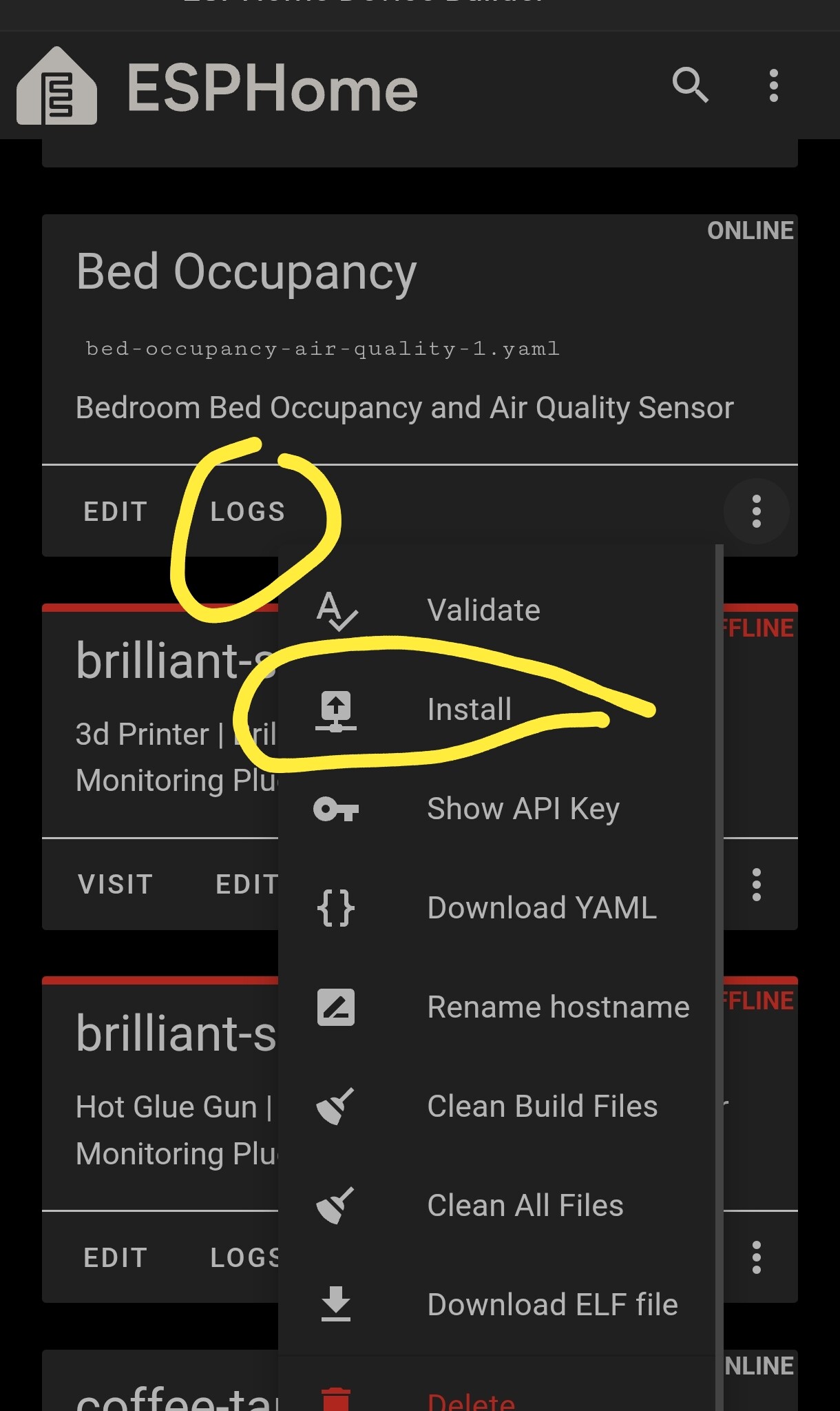

Generally for ESPHome the best logs to post are either the “build” ones (via install), or the “operating” ones (via Logs".

Sorry about my english.Watch carefully,where rows starts.Ifs very important
I’d suggest carefully “merging what you have into thiers”. So add your wifi details etc. Selectively replacing thier values with yours.
It will help if you start reading the docs a little, to get familiar with how it needs to come together. For example,
For the substitutions (see docs) my suggestion to get started is it is best to stick with their config and change things once you understand them if needed.
This is a hurdle. You will probably have a much easier time if you can find the sellers config for your older board. Try the internet or contact the seller. Otherwise you’ll need to navigate pin mappings and other changes yourself.
Possibly you need this one.
The seller sent me a yaml that is supposed to be for my device. I installed it, but got wifi and IP address errors. So I am now following the instructions on the link regarding wifi configuration you sent and hopefully that will take care of it.
No joy. I still get the same error:
