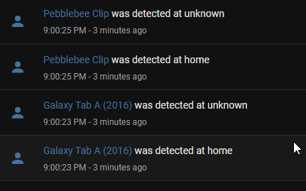

I’ve got the opposite, I get location, then unknown
I just found if I remove this line of code then it doesn’t report unknown
client.publish(f"{base_topic}/state", state)
But I’m not quite sure if that throws it off in other ways, but it seems to be working for me. According to the MQTT device tracker - Home Assistant docs it states: Using state_topic is optional when using json_attributes_topic to determine the state of the device tracker.
It seems your PR addresses this somewhat but I still got unknown state with it. But when I removed the above line I no longer got unknown state after each update. Although I haven’t tested it with Semantic Location.
More testing and yes when a Semantic Location is reported my hack didn’t work. But with a few small changes I think I’ve found a way to work with Semantic Location, and not have the unknown location state reported just before the real state. I’ll follow up in the PR you opened.

  6. (Optional) Prevent entities from flipping to “unknown”
    If you prefer that entities don’t switch to unknown on every update, remove lines 115–117 in publish_mqtt.py.

  • Replace the device name filter string with your own devices, or leave it empty to include all.
  • I currently restart the container every few hours because the script stops working; overall it works, though.
  • If you don’t want use docker-compose you can use the command from step 3 in the original repo instructions.
I hope this helps someone!
Cheers
Harry
i have a question, is kind of noob, because i’m still learning about docker…
when you run “pip3 instal -r requirements.dev.txt”
this will be installed on the docker host, not the container that you will create after? or these instalations are need for conteiner start on this host?
I supose that a conteiner is all packed plugins, instalations, and addons necessary to run an application to work and not need to install anything on host
The pip3 command installs the Python requirements on the host. These are required in order to run main.py and create the secrets.json file. These requirements are also installed in the container when it is built.
These requirements are not needed to run the container. Everything that is needed is inside the container.
I hope I could clarify it.
Cheers, Harry
I am currently working on a Home Assistant integration. I have it working to the point of not requiring any external scripts, docker, or MQTT integration to run normally.
The only unfortunate thing is the authentication sitll requires running main.py on a different computer to get the initial token from secrets.json. I’ve been trying to get the auth workflow merged into my integration but have unsuccessful up to this point. Still kicking around different options if anyone has any ideas.
I don’t have it up on GitHub public yet. Potentially next week once I’ve let it soak for a while.
drumroll
