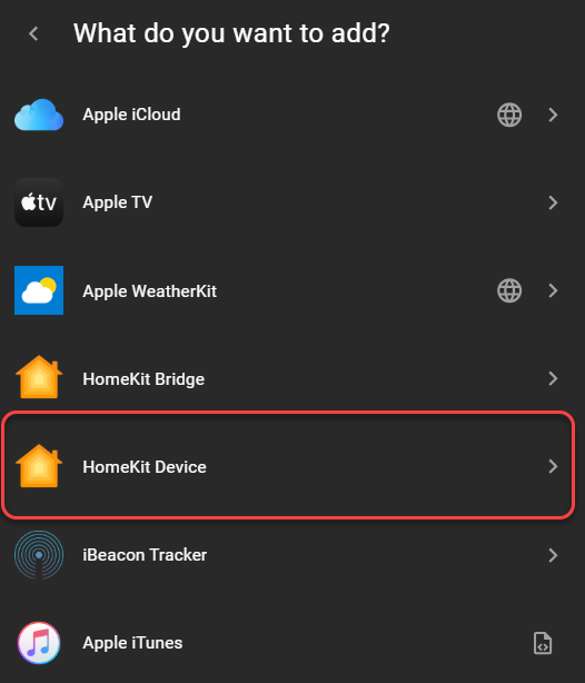

I can get my Zigbee locks to work in HA, but cannot get the Level Locks to show in the Homebridge Integration setup.
This is not the way you want to do it. Pair your HomeKit devices with HomeAssistant - ditch HomeBridge, you no longer need it.
Do you mean picking the item circled in the attached screenshot, and not the item directly above it?
Yes, precisely. Use that to pair the lock to HomeAssistant (while unpaired from Apple Home). You can then push the lock through to HomeKit using HomeKit Bridge.
