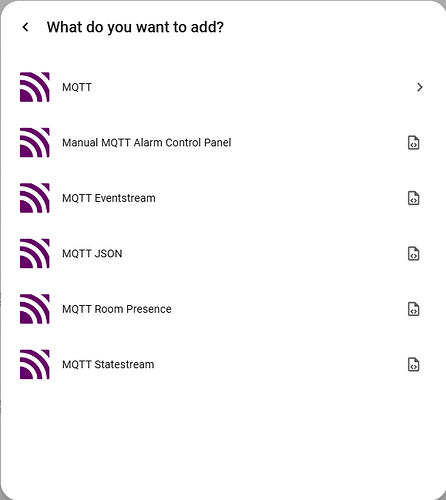

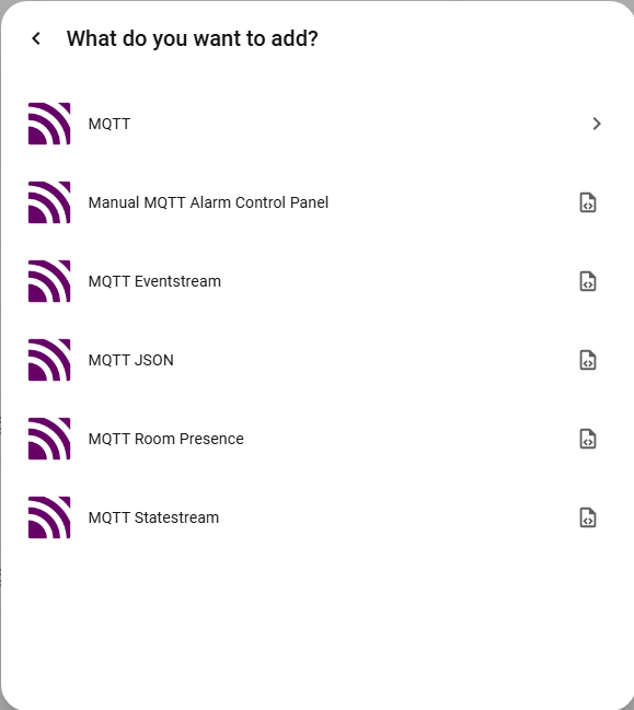

But here's an example of the issue I'm having. This page
Talks about the mqtt sensor integration. But when I go to add an integration and search for mqtt, I get the following:
None of which mention an mqtt sensor. Undoubtedly this is me just not grokking the HA way of doing things yet but I'm trying to hit the learning curve pretty hard.
