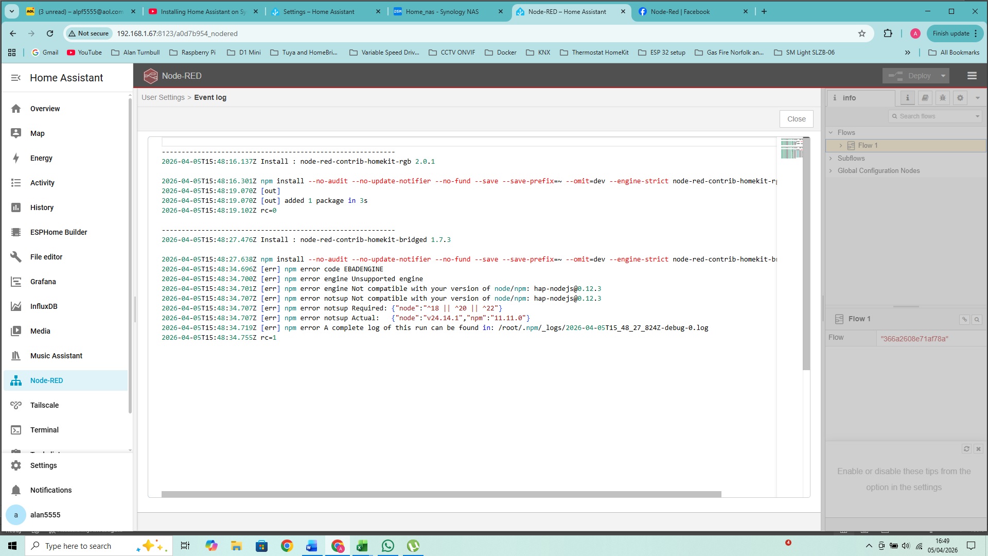

I have installed Home Assistant on a synology Nas and then added Influx and Node Red but when I went to add Homekit Bridged Node I get an error message. I have pasted the error message below.
I am told that Node Red is not recognizing the version of Node Red I installed with Home Assistant.
Does anyone have an answer for this problem

The node you are trying to add, contrib-homekit-bridged, has a set of dependencies in the packag.json file that include:
    "dependencies": {
        "@nrchkb/logger": "~3.1.1",
        "hap-nodejs": "0.12.3",
so this node is calling for hap-nodejs, and version 0.12.3
Also, hap-nodejs itself has a dependence set for node.js as version 18, 20, or 22. Now that we are on node.js version 24, this dependence fails. Ideally this should have been a dependency for 18+, but it was written for specific versions, so v24 will fail.
The problem is that the author of contrib-homekit-bridged has not updated the dependencies, since hap-nodejs is now on version 2.1.2, which will work.
Apart from editing the package.json to set the hap-nodejs dependency yourself, you should contact the node owner by issuing an issue on GitHub.
