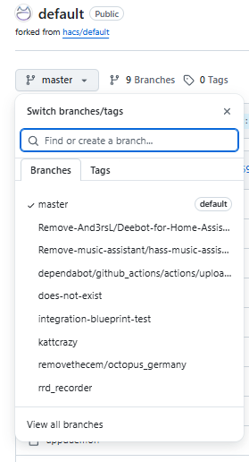

  2. Make a fork of HACS/Default. BEFORE you edit it go to [your repo’s url]default/branches and press New branch and choose master as the source. Make sure you’re on your new branch- in my case I named it ‘kattcrazy’.
