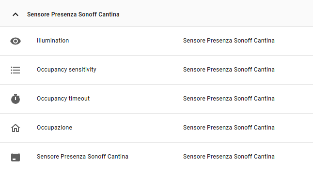

It was not perfect but worked most of the times. Now I’ve bought a Sonoff Presence Sensor (I think it works using mwaves) and I would like to add this to the picture, so that lights would stay on when someone is in the basement, even if not moving.
The problem is that I have no idea how to add the presence sensor to my automations, nor how to write a completely new one that serves my purpose.

What entities did the Sonoff Presence Sensor add when you installed it?

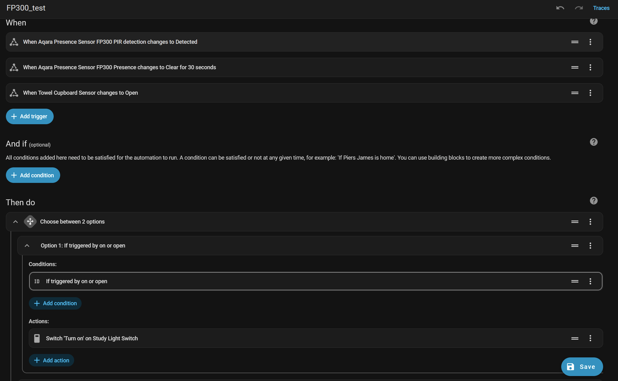

In respect of the presence sensor, I have the Aqara FP300 and it offers PIR movement detection and mmwave presence. At the moment, I am testing it but I have the following triggers:
The first turns the lights on and the second turns them off. Adding in the contact sensor, you would end up with something like this:
The triggers have IDs and I use those to determine which action to perform in the ‘Then do’ section.
These are the entities of this device.

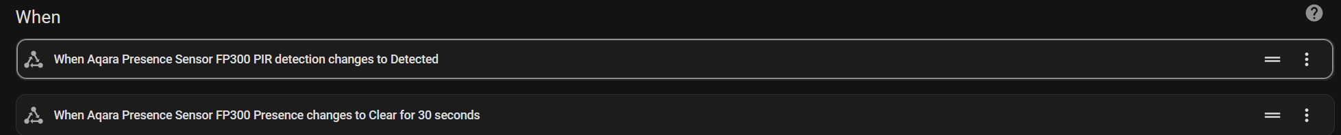

It looks like you are using devices for triggers whereas you should be using entities. Here is my YAML for my triggers:
alias: FP300_test
description: ""
triggers:
  - trigger: state
    entity_id:
      - binary_sensor.aqara_presence_sensor_fp300_motion
    to:
      - "on"
  - trigger: state
    entity_id:
      - binary_sensor.aqara_presence_sensor_fp300_occupancy
    to:
      - "off"
    for:
      hours: 0
      minutes: 0
      seconds: 30

The turn_on condition is simple - turn the light on.
In all other circumstances it checks the current status of the motion detectors and sets the light status accordingly.
If you open the door for the cat - since the motion detectors won’t pick it up the 3 minute timer will fire (or if you close the door) and the light will go out.
Otherwise if someone is in the basement the motion detectors will take priority.
