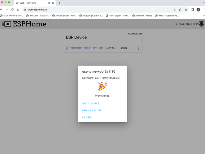

Ok so whilst I wait to grab my Mac mini from my girlfriends house I thought Id see how far I could go with installing the Yaml onto the esphome. I used ESPhome web to first set it up on my ESP32.
Im not exactly sure what order this was all done in as Im now at work but I clicked on the 3 dots and chose install. And created a YAMl called kegscales. (See screen shots below.) As I left for work it was still installing. is this when its most likely to crash?

Yeah, mine always just crashed at some point during compiling (HA would go down and I’d have to power-cycle it). It took quite a while before realized it was an issue of it just not being capable of doing it versus me doing something wrong.
Ohh ok yeh well at least Im learning what to do so when I get the mac mini I can do it all again on that.
So is it writing this script or file to the ESP32 or to the Pi itself?
