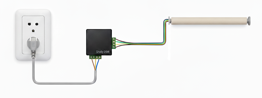

I have a roller blind that’s powered via a plug-in cable, and it can currently only be operated with a remote control.
I’m thinking of making it smart using a Shelly 2PM (Gen4).

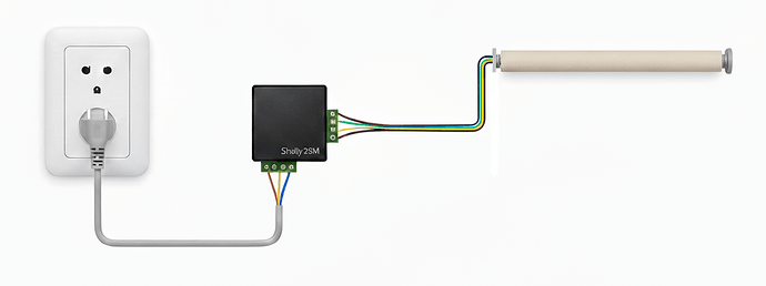

Would it be possible to cut the plug cable and install the Shelly 2PM inline between the plug on one side and the roller on the other in order to control the roller via the Shelly 2PM?”
Something like this:

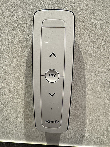

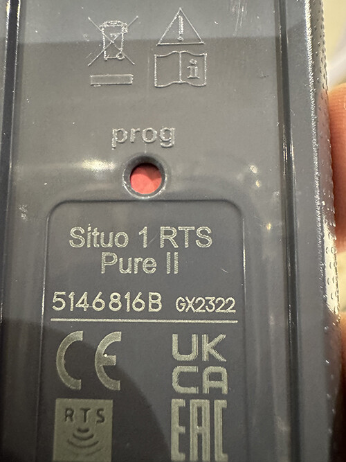

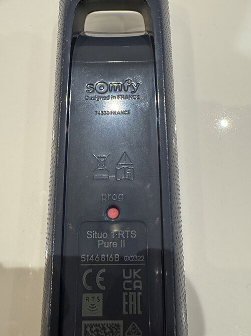

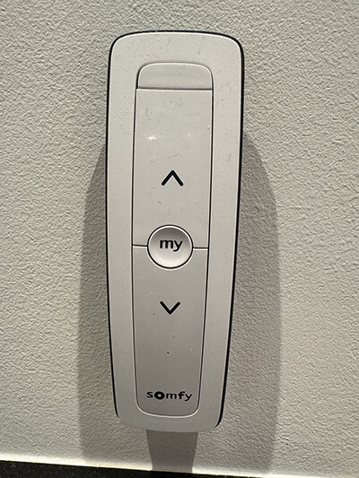

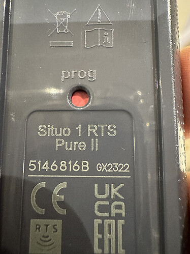

Images show the front and back of the remote control.
Manual:
Your post is all about the remote control. Instead what we need here is the model of the motor.
