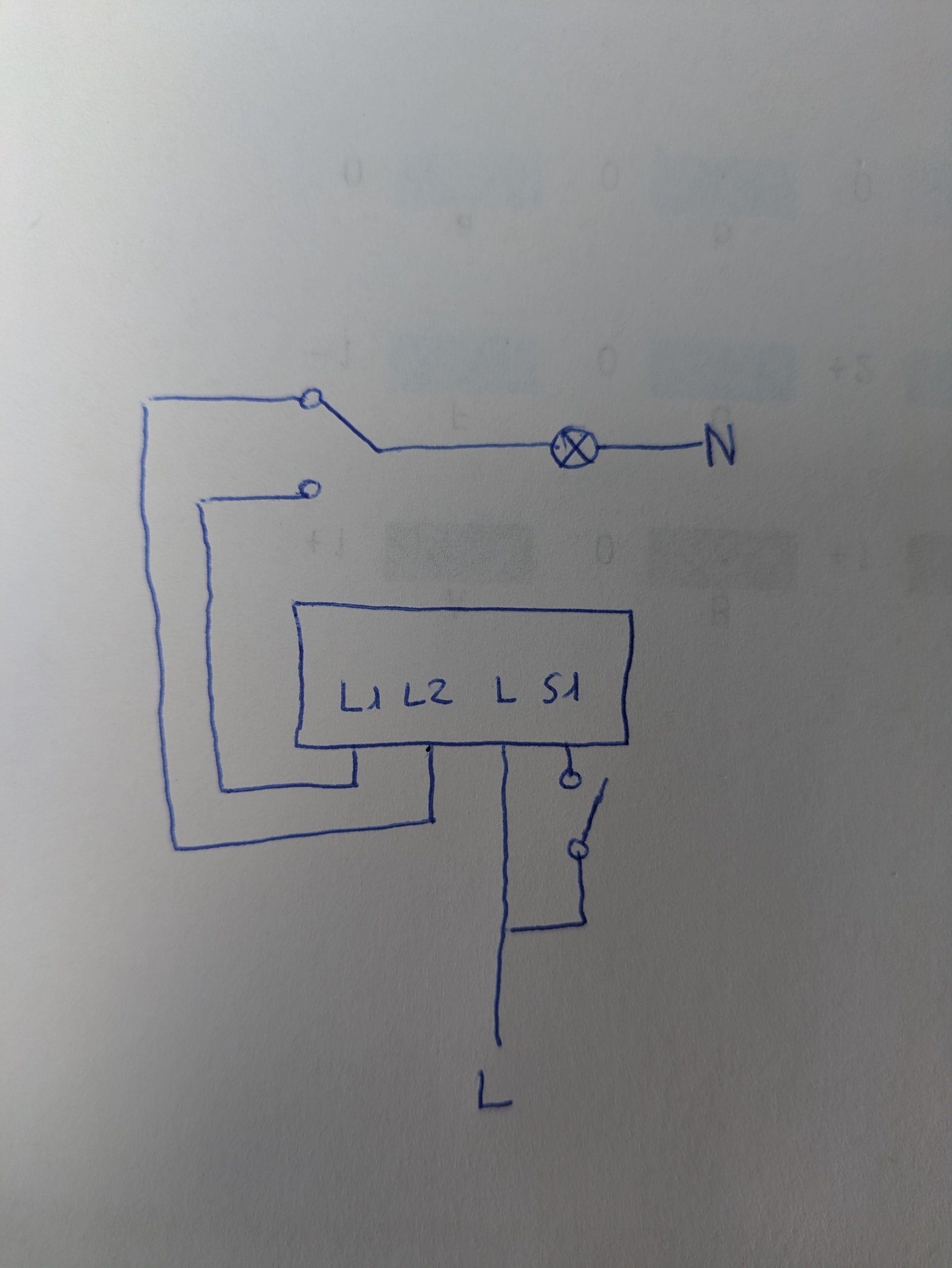

I'd like to install a smart switch to the usual 2 way switch circuit. One of the 3-way switches is connected to Hot, the other to the load and 2 wires between each switch (as a newbie I can only attach one image). But I'm struggling to find a solution to avoid passing an extra wire.
I was thinking if it would be possible to replace the 3-way switch that is connected to Hot with a double channel smart switch without neutral along with a regular wall switch.
Then, it would be a matter of programming the smart switch as a 3-way switch so when the input switch is triggered, it would toggle the Line out between 1 and 2 outputs.
This is a schematic of what I have in mind.
Is there a better solution? The big problem here is that there is no way of knowing whether the lights are on or not. So it shold be implemented with a light sensor that toggles the switch when it's too dark.
I realise I may end up passing an extra wire so I can set it up with a regulars smart switch, but it's quite a long run and pretty tight. I think I would have to remove the existing wires and pass 3 new ones in one go.

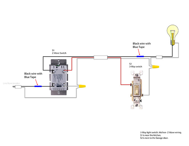

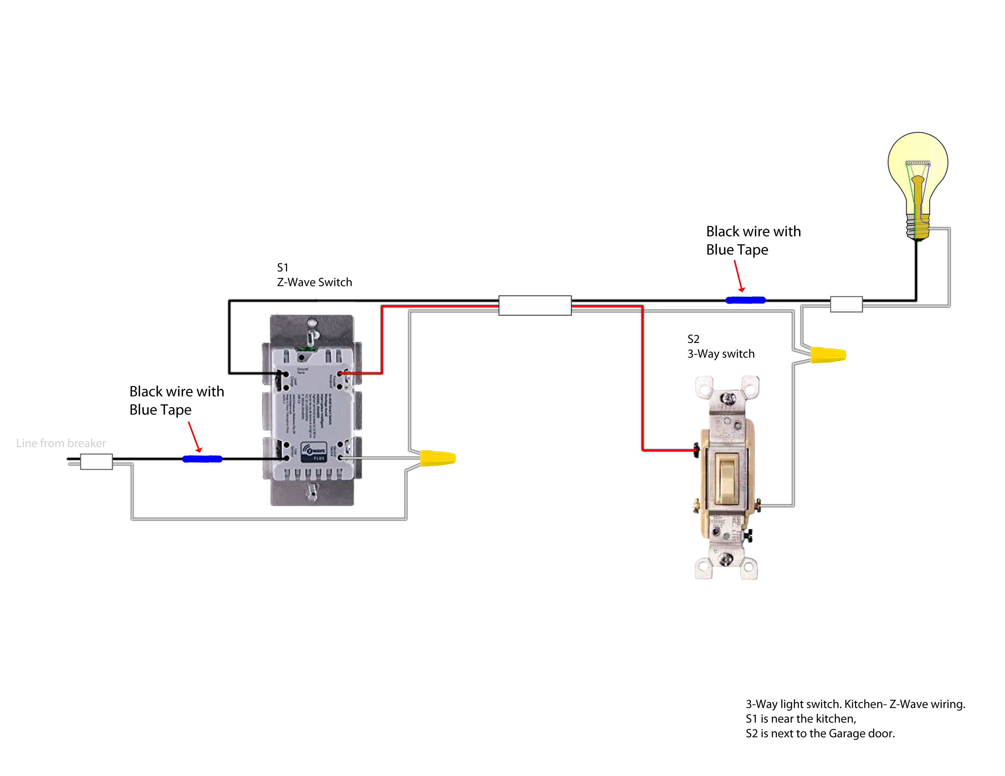

This is usually the simplest solution to most setups:
Simple. Use a smart switch that has a remote connection. This is what I use in my kitchen.
(I used the blue tape to identify which black wire was which)
