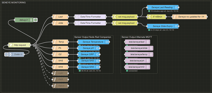

Yes can do, I am on a tablet at the moment, I will upload to NodeRed Flows Library so you can download it from there.
@Andy8912 Please see flow attached with a bit of a clearer write-up for anyone else wanting to integrate using NodeRED. Big thanks to @notovich for working this out for us.
https://flows.nodered.org/flow/c84c563ae1b73a0315bde0e9c6fd965a

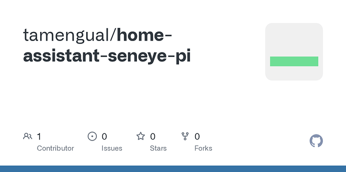

So while that did work for a bit I ended up finding that the sensors would drift significantly. I ended up going for a different and much cleaner solution. I switching the raspberry pi to being a USBIP, connected that to home assistant through the USBIP custom Add on then created a custom integration to read the sensors. Now it shows up with sensors accurately and updates every couple of minutes. Here is the link to the newly updated integration:
