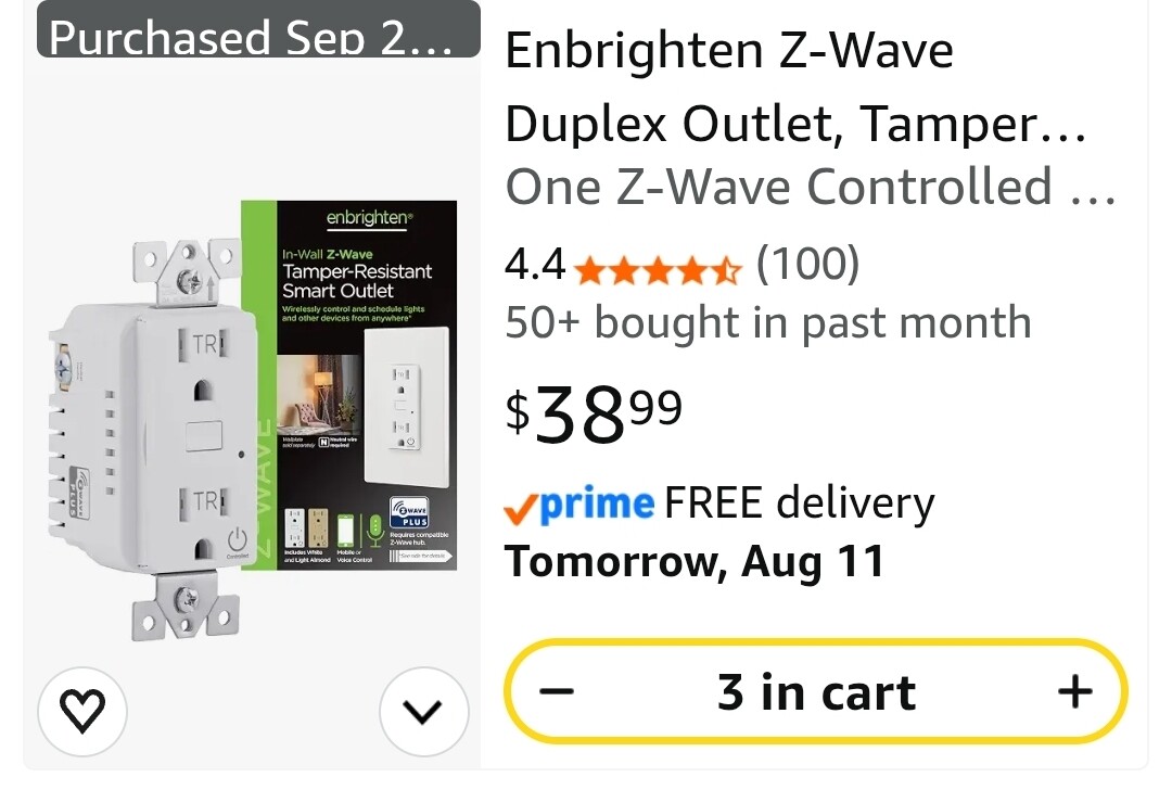

Eg. Decora ZWave single gang 15a smart outlet
My system has a ZWave antenna so ZWave… That device is from Ge/Jasco (a Major manufacturer) Is an outlet (I personally need an outlet) and has full ZWave support. I’m good (get good at this once you picked your radio tech.)

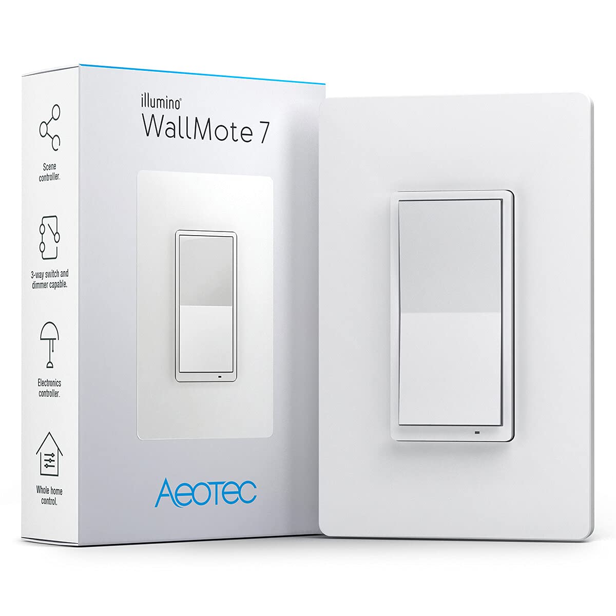

If you want/need additional switches in a room but don’t have wires going to where you need them, you might have to use something like this:
