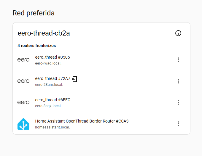

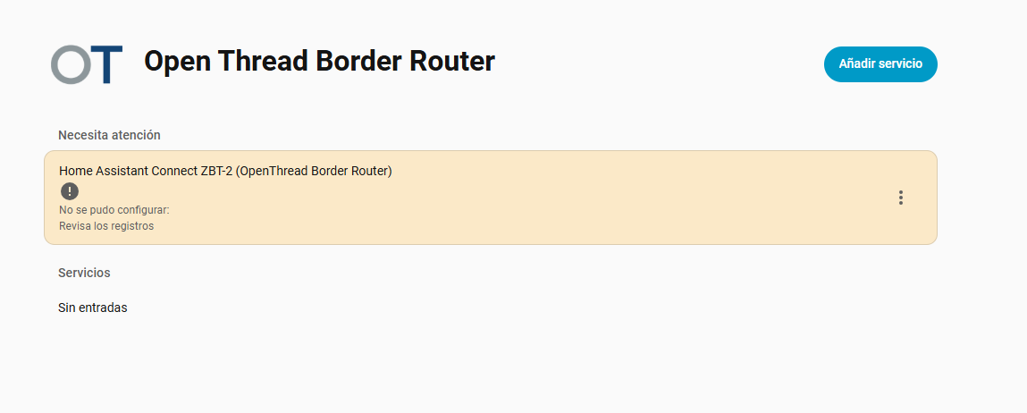

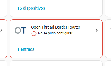

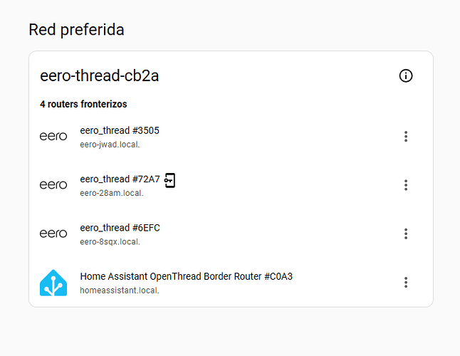

Hi, I just set up ZBT 2 yesterday. Apparenty it’s ok. However, It seems there’s something wrong with the Open Thread Border router add on. I’m providing some pictures so You can get an idea. Do i need to proceed and configure the OTBR add on, or leave like that? Thanks…
I think the OTBR Integration is no longer talking to the OTBR App/AddON.

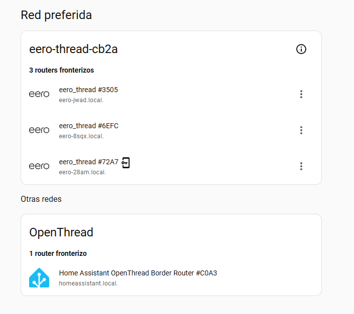

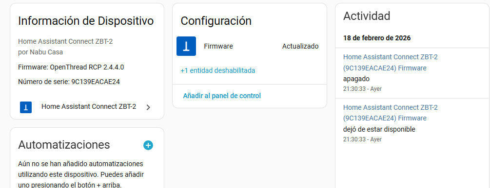

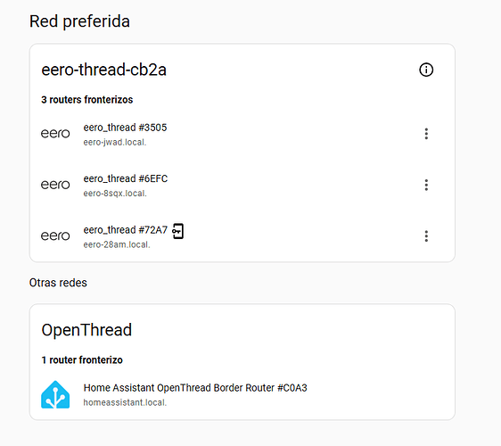

I restarted the add on, and now it appears like this. But the add on looks still the same. (something wrong) What I dont know is if the zbt- 2 is working as it should right now. (or before, when it was part of the eero thread network) It seems so, because now I only have one device, the most remote, that is connecting and disconecting randomly. Before that it was much worse, Right now, my five thread devices are working fine.
For some reason, the Thread and OTBR Integration are not talking to the OTBR AddOn over an internal websocket (which are auto-magically established), but the Thread Integration is seeing the OTBR’s mDNS advertisements which means the OTBR AddOn is running.
Take a look at this thread regarding a “URL” to see if you can find anything that helps.
