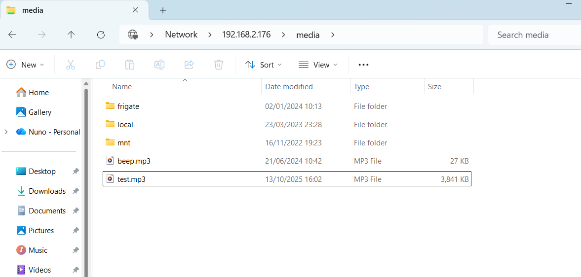

Yes I already have the file into the Home Assistant server
Also in order to avoid any issue with names or special characters I rename de file to test.mp3, but I still not able to play the or stream the MP3 over the addon GO2RTC …

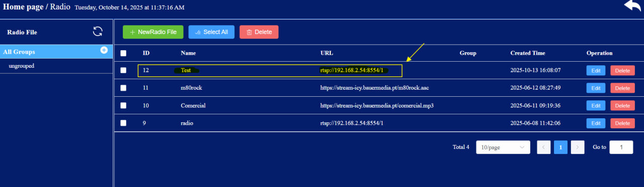

I think that once I already have the smart speaker, the Addon GO2RTC only work as a stream server, please correct me if I’m wrong.

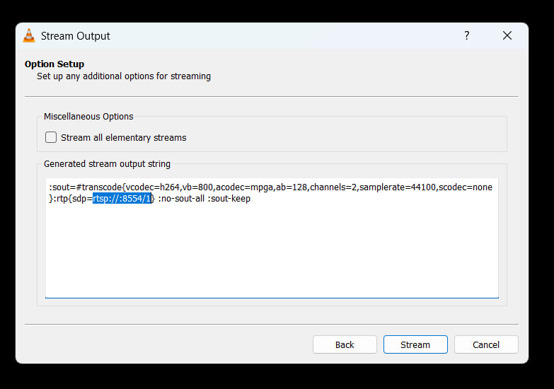

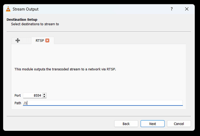

And, in that case, the unique configuration that I need is the one to put some mp3 file streaming from the server addon like somethings like this:>
rtsp://192.168.2.54:8554/1 (Configuration present on the Smart Speaker WEB GUI)

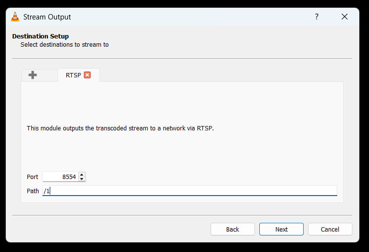

That is the configuration that I have when I stream coming from the VLC

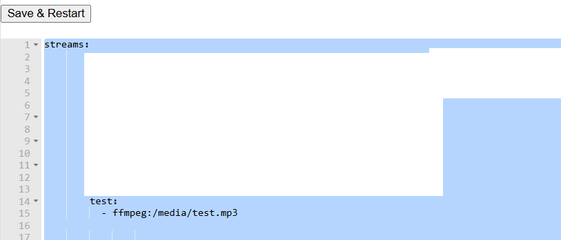

OK now I get it, probably :slight_smile: Just tested this in VLC and it plays mp3, so hopefully your speaker can play it, too:
stream:
  file_test:
    - ffmpeg:/media/forest.mp3

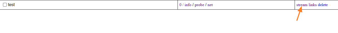

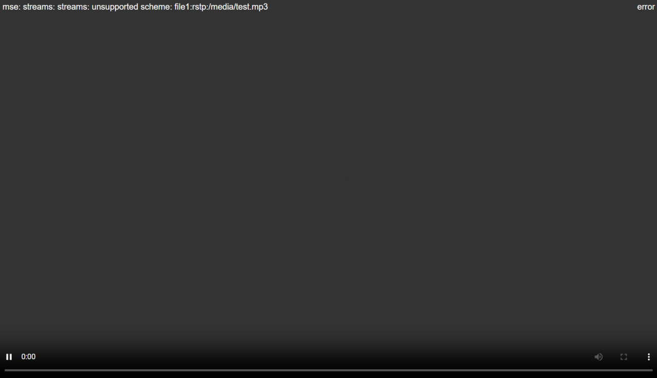

I created a new entry as your indications:

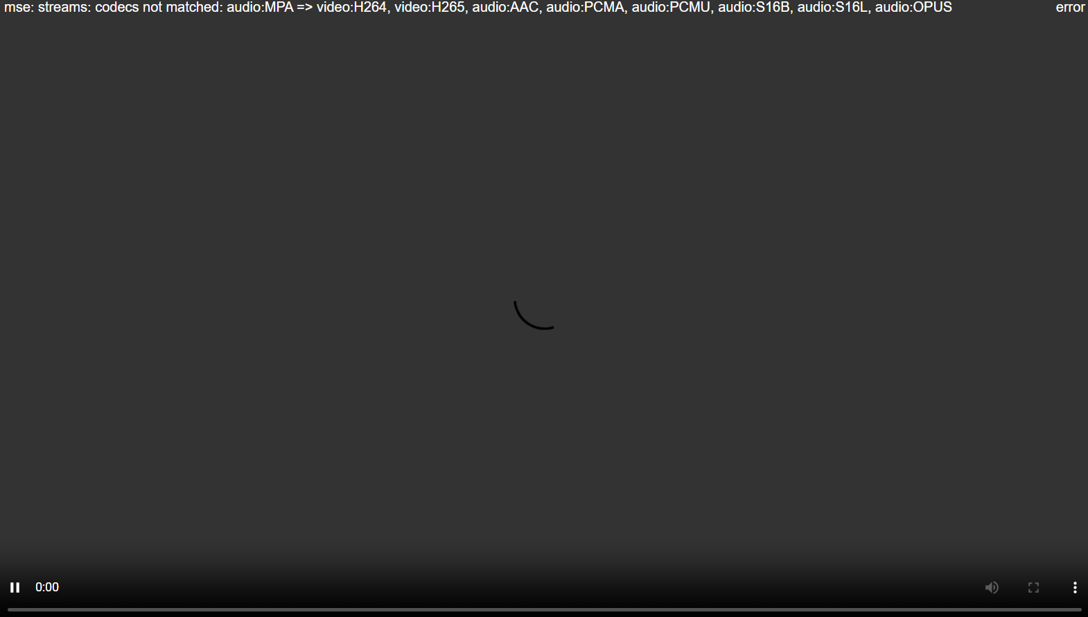

After this I try to play this stream using the addon GO2RTC GUI without sucees
I think there is a issue with some codecs… ~
Do you have any ideia to solve this?
Thank you
It doesn’t work in go2rtc GUI but does work [for me] as RTSP. You don’t test RTSP in browser - use VLC or your speaker and don’t forget the ?audio (or ?audio=all) at the end because it changes the response of go2rtc addon.
